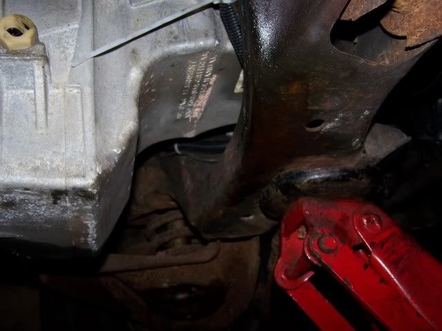

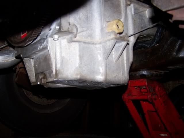

Can anyone tell me with certainty if the truck oil pan will clear the stock g-body crossmember? That's my first concern. Also, wonder if the truck manifolds will fit the g-body without modifications?

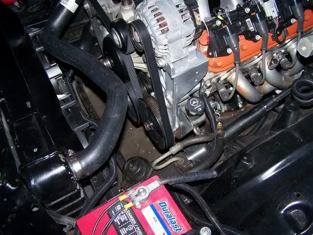

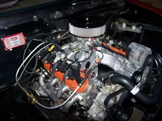

plenty of room, I could have moved the engine forward more, but I set it up from the driveshaft forward, the pass side head cowl area needed a little hammer time, the motor is totally behind the crossmember, should help with weight transfer.

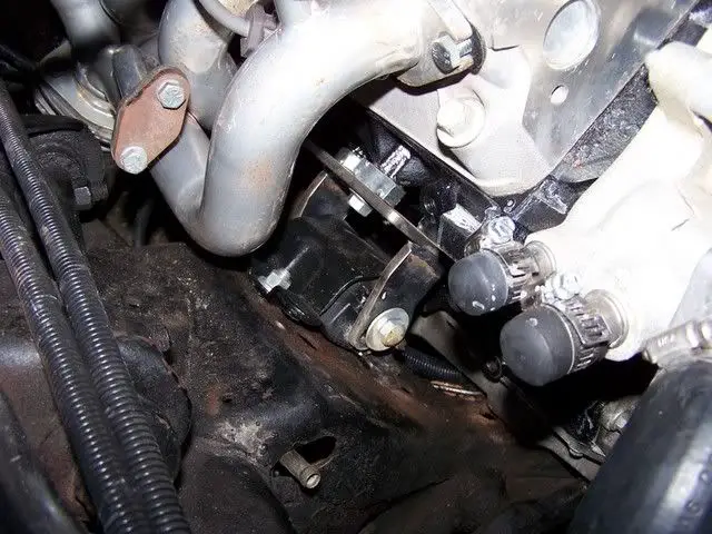

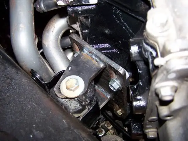

headers, edelbrock LS1 firebird shorties, plenty of room, Mounts.. S-10 ls1 swap mounts, I had to shim them up 1/2" for now, I used cheap AutoZOne frame pads and they settled bad.
Front accessories...stock truck, power steering works perfect...just grab a metric 16x1.5 fitting for the pump side and compression it to the malibu 18x1.5 box fitting. Alternator is a 1 wire, stock 1999 S-10 4cyl, 105 amp.

Why did you have to shim the S10 adapter mounts? To allow the header to clear? Also, why did you use a S10 alternator, why didn't you use the truck alternator?

no, the cheap rubber in the frame mount compressed over about a week and the front of the pan has a small hump that was getting close to the crossmember. You can get the adaptors to use the old school 3 hole stock chevy mounts, I had these so I used them. this is a 2005 motor, I tired that alt but couldnt get it to energize, I was told the newer ones use the vehicle computer to energize it and regulate thats why it didnt work.
