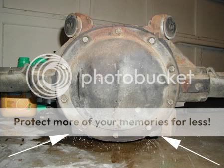

Here's a pic of a GM 8.5. A 7.5 wont have the ears on the bottom.

The large square ears on the bottom of the case are 8.5's, the small pointy ears on the bottom of the case are 7.5's...
