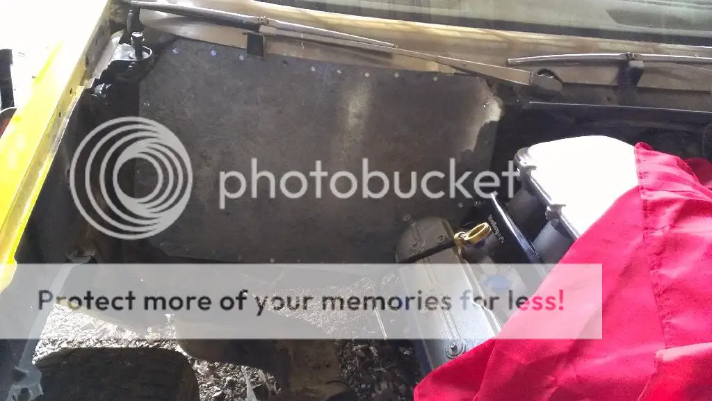

got the fender wells and ac box pulled yesterday. cam and springs changed yesterday. couldn't find a valve spring tool, so i drilled a large hole for the retainer and a small hole for the rocker bolt in a piece of angle iron. it worked really well actually...

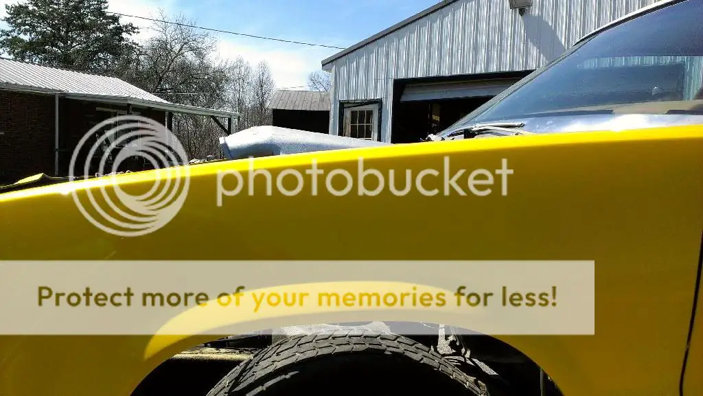

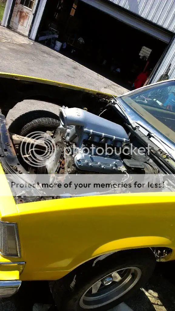

today i sat the motor in the car. pain in the *ss, in and out four times. finally realized i had a setback plate which threw off the geometery of the SBC solid mounts. drilled holes in the frame aproxamately .5" hicher center to center than the existing ones. fit perfect! put the hi ram on in the car, sum b*tch is high. I don't know if a 4" hood will clear... be close.

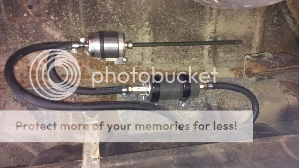

working on fuel system tomorrow, have a question.
there are two metal lines coming from the top of my factory tank, one larger than the other, both head towards the passenger side, cross over the top of the axle, and only one comes down. whats up with that? can i use one for a feed and the other for a return? i bought new fuel line so i dont want to use much of it since it's not efi rated, just a few inches of it so i don't have to drop the tank.
ideas?
