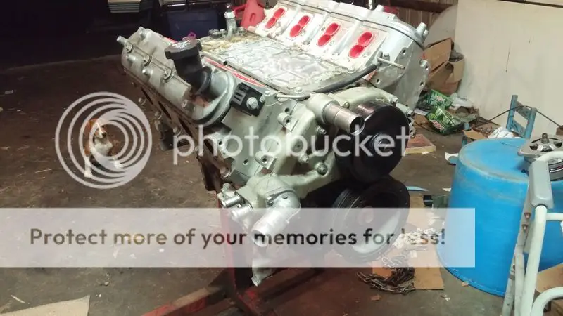

Just stuff some paper towels down the intake and exhaust ports? Don't Really wanna have to pull the heads

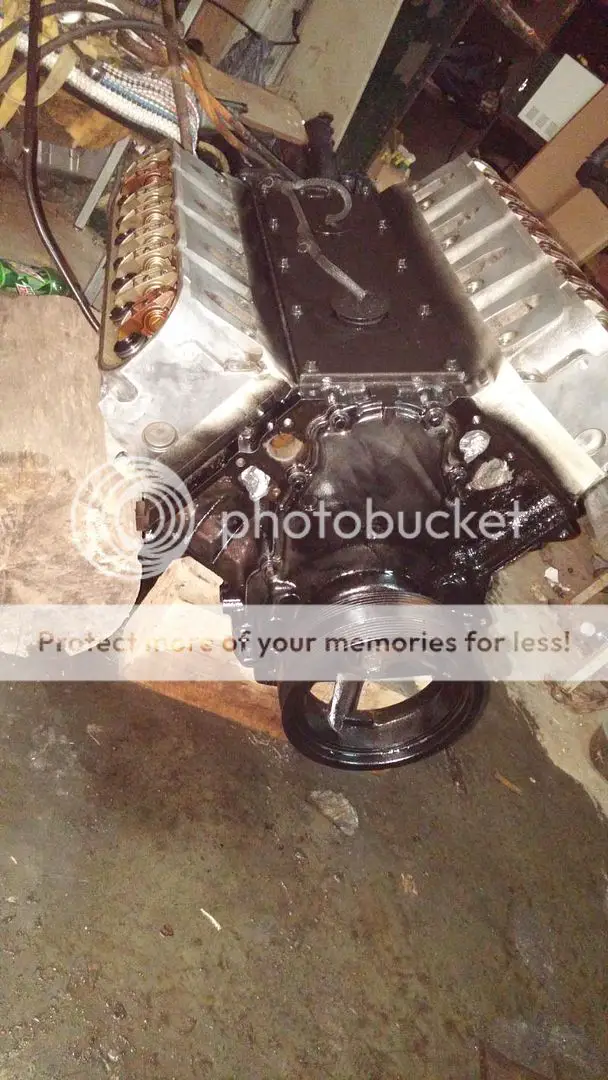

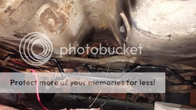

Crossmember is done, except for sitting the engine and trans in to know where to put my mounting tabs at. Wish I had a fbody pan to gain a little ground clearance. Going to try to get the motor painted And in by Sunday, hope to have the new rear in too.

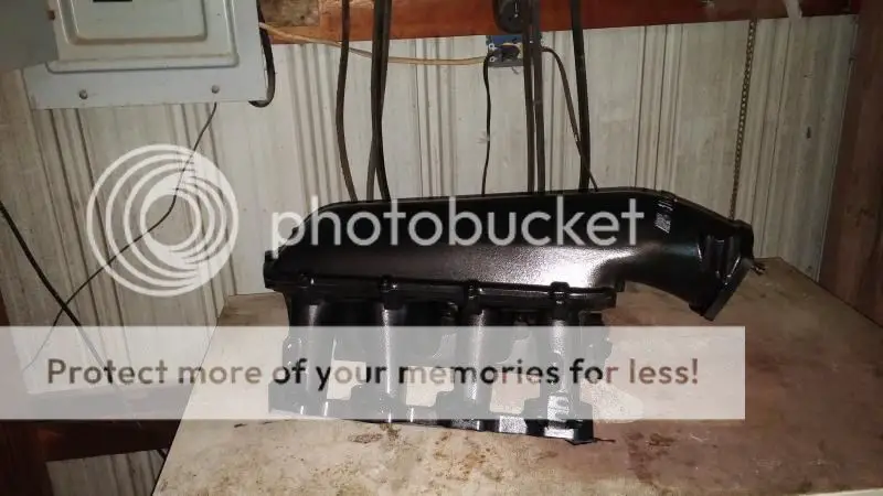

finished painting the lower part of the intake, I like it so much better than the natural aluminum that holds grease and dirt! cleaned the motor up and spray bombed it, pretty happy with how it looks, needs another coat of paint and then have to clean and paint the coil brackets and accessories. Supposed to be record cold tomorrow, somewhere near negative 15 i think. Its kentucky not minnesota. I'm so ready to move south, deep south like miami!

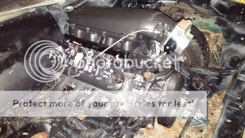

Motor and trans back in car! Mostly wired up, probably a couple good weekends left. One devoted to wiring switches and relays and the other devoted to plumbing the new fuel system. After that it'll be back on the road. Not sure when I'll get the rear swapped out...

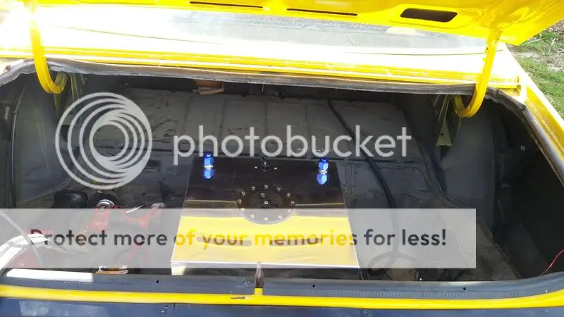

a few pictures of todays progress. pulled the gas tank and put in a new 10 gallon cell, ran some -8 line to the front and plan on using the old 6an as a return. bolted in the pumps then got mad because i couldnt find my 'y's lol. hope to find them tomorrow and button up the fuel system.

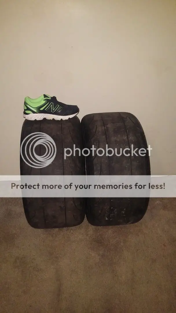

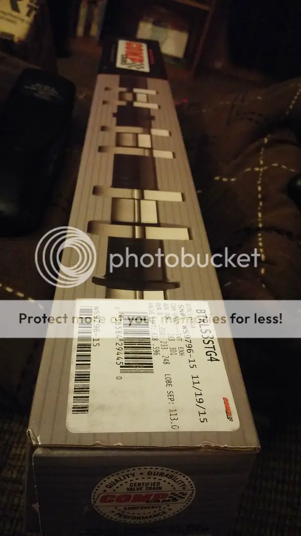

Before I pulled it apart, I replaced the huge intake with a stock truck intake and replaced the worn out slicks with a 255 et radial and got the car to some pretty consistent 7.9's with a 1.7x 60'. After that I got some 3.5" front runners, Moroso trick front springs and put in a smaller cam (224/230 114). The car picked up a TON of torque and I don't feel it lost anything before my shift point.

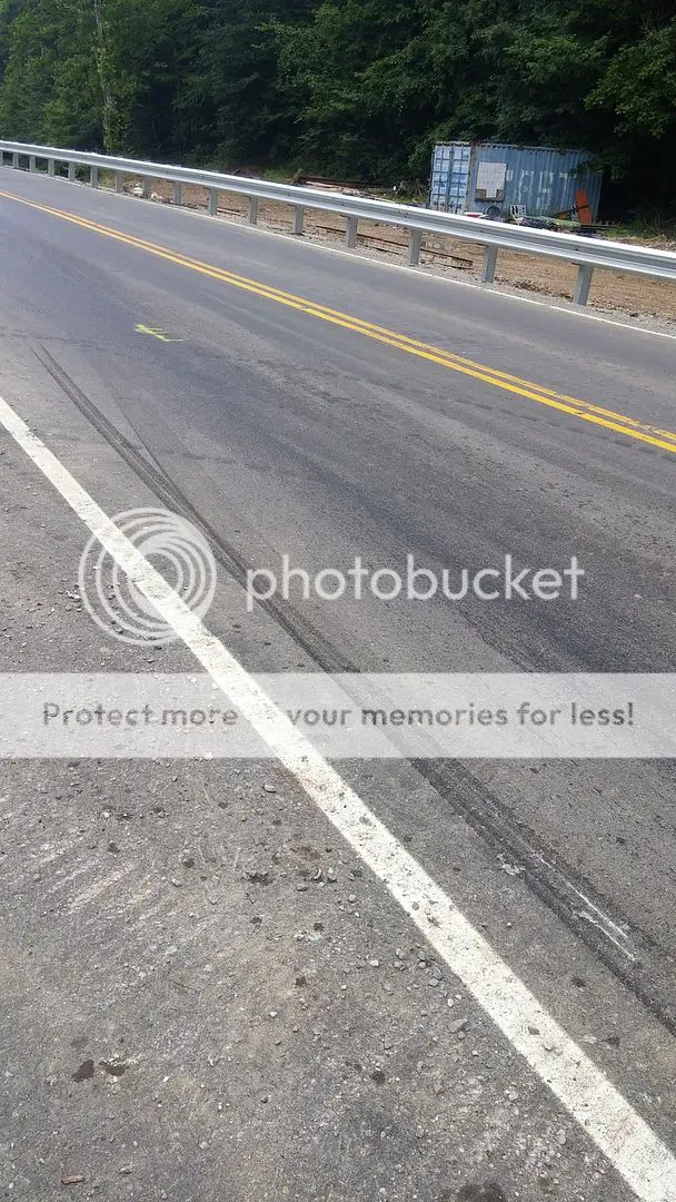

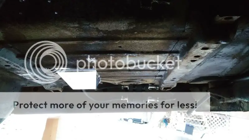

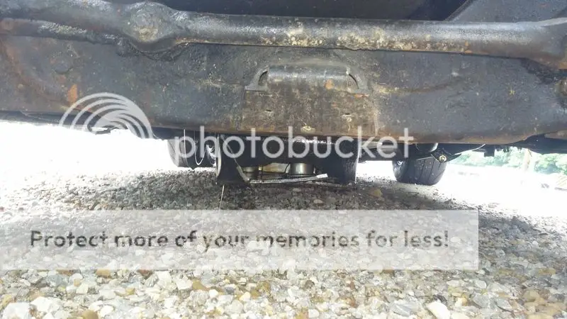

UNFORTUNATELY, I didn't get back to the track with the new setup. A valuable lesson for all LS swap guys... Don't use the truck pan! Slowed to about 40 in a construction zone (55mph) and still dipped down and ripped the pan off on a bridge lip with my wife in the car. almost lost it with the oil under the car (and her clutching my right arm). Happened on July 4th on the way to a family cook out.

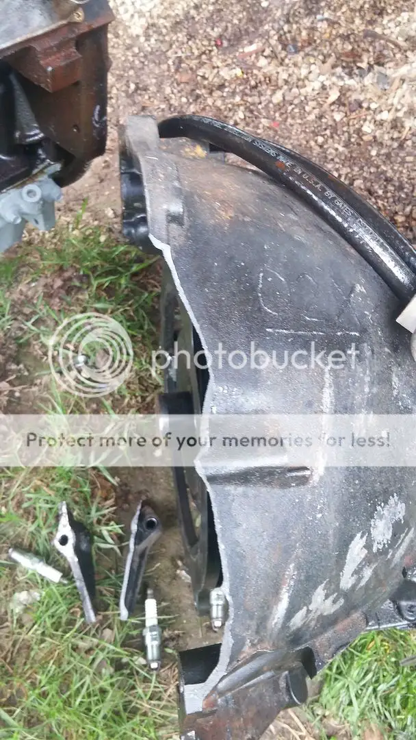

After pulling the busted pan motor to swap out the oil pan, I noticed the bell housing on my PTC th400 was cracked so I went thru some dark days and gutted the whole setup lol. Going to put a JW bell on the trans, a fbody pan on the motor and use it in my wife's mustang swap.
