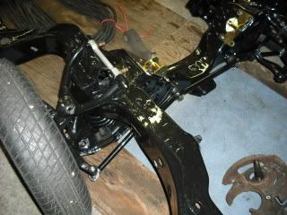

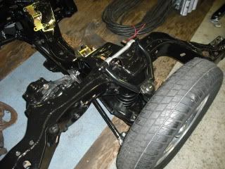

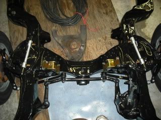

please explain in terms that i understand. i have two of the speedway right hand uppers and all seems to be lining up DAMN close with string and level etc... we will see for sure once i make it to alignment shop. i have read/heard that a 1/16" to 1/8" of toe in is appropriate and 0 degrees camber to as much as 7 degree positive caster is appropriate for a drag car...
