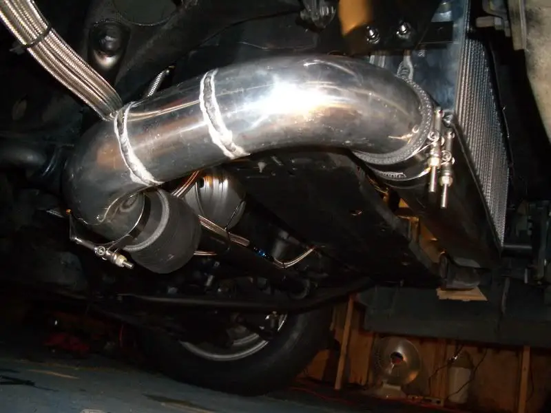

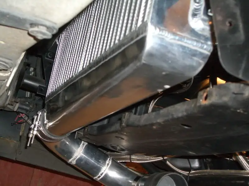

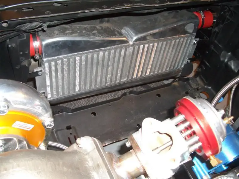

With an 88mm and a 6.0l your going to need a GOOD sized A/A.
Is this a street or track set-up?
There are several W/A that could work. Add a heat exchanger and pump. You could add a Tank as well and run both on water and/or ice.
A passenger footwell mount W/A would work well.
