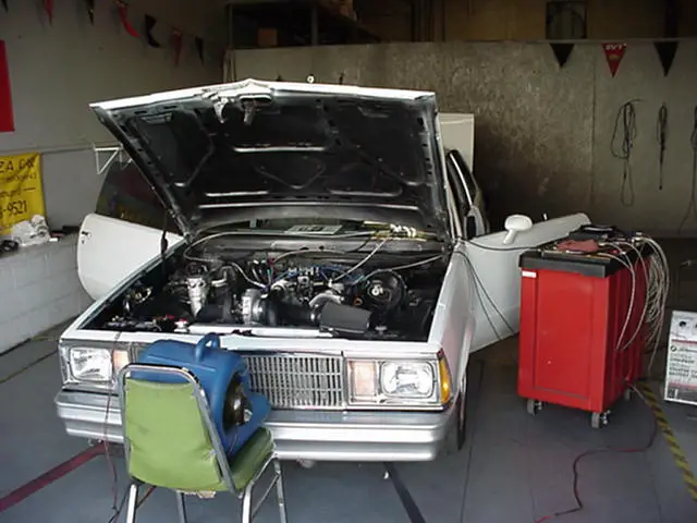

Why dont you have room? Are you still running a/c? This is my old car you can kind of see the A/A on it. Go to this link and scroll down to the bottom and you will see the finished product on my A/w.Bad Medicine Racing said:Mine is not here yet (ordered it Thursday), but it will be the 3 nozzle. One pre turbo and 2 more in the charge pipe. I don't have any plans to change my fuel curve, as it is blow thru. I don't have any room for an A/A and I don't want the weight and plumbing of an A/W so I figured I would give this a shot. If it cooks a piston, well it won't be the first time someone has done it lol. I'm just looking for a way out of buying C16 every time I go to the track and turn the wick up a little.Robert1320 said:The issues with meth spray kit is eventually everyone keeps leaning on them harder and harder. Thus the meth enters into the fuel curve. Meth will need to used a large quantity (vs gas) to not go lean. That is why you see the meth kit with 3, 5, 163 nozzles..... (maybe not 163). You get the point it need a large quantity.

My fan is a pusher in front of my radiator, and I refuse to cut my core support.blue t said:Why dont you have room? Are you still running a/c? This is my old car you can kind of see the A/A on it. Go to this link and scroll down to the bottom and you will see the finished product on my A/w.
