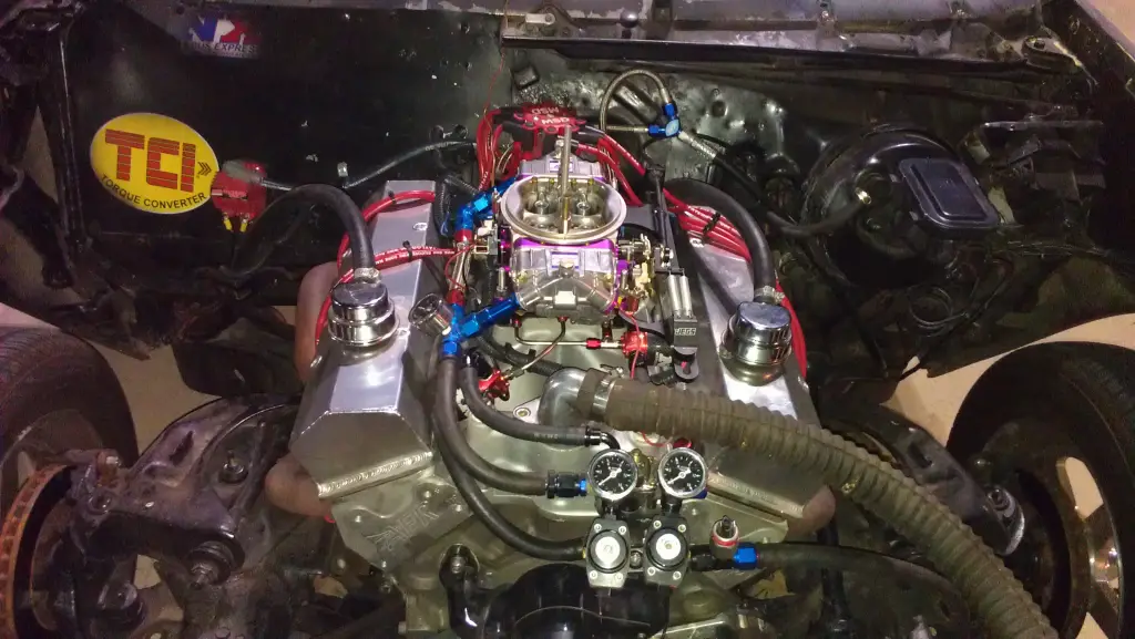

I am wanting to put a two stage system on my car. My question is how to take the proper amount of timing out for the second stage. I have a digital 6 so the first stage will be retarded off that. And also id like anyones opinion on the 2 stage for sale here. Its not a cross bar its a parallel bar. I've heard the bottom bar might freeze up when the top is activated.thanks for any guidance. Big Papa.
