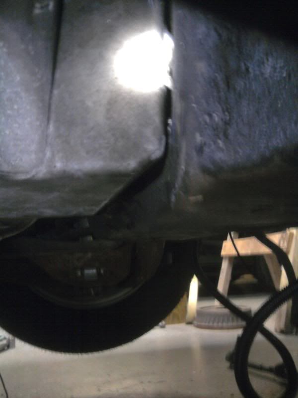

Will it work? I have the Mast pan, debating selling it cause oil pressure tap is a PITA, debating going with F body one. Anyone know for a fact if it will or will not fit?

I have that setup and it fits, but it's really close. You have less than an 1/8th inch from front to back clearance, but side to side there's plenty of room. I haven't noticed any issues with mine so far, but If i ever pull the engine in the future I'm going to notch out two small places in the cross member for added security.

Here's a pic

That is with the 1" setback mounts?

Yes, I ordered them from "The Car Shop Inc." a few years back.
Very good quality stuff.

There is much better clearance with the cts-v pan. It does hang slightly under the crossmember, but its less than an inch.

I was looking at the CTS-V pan too, but it was quite a bit taller & was looking at the baffle with trap doors from Improved racing, but only fits in the F body pan.
