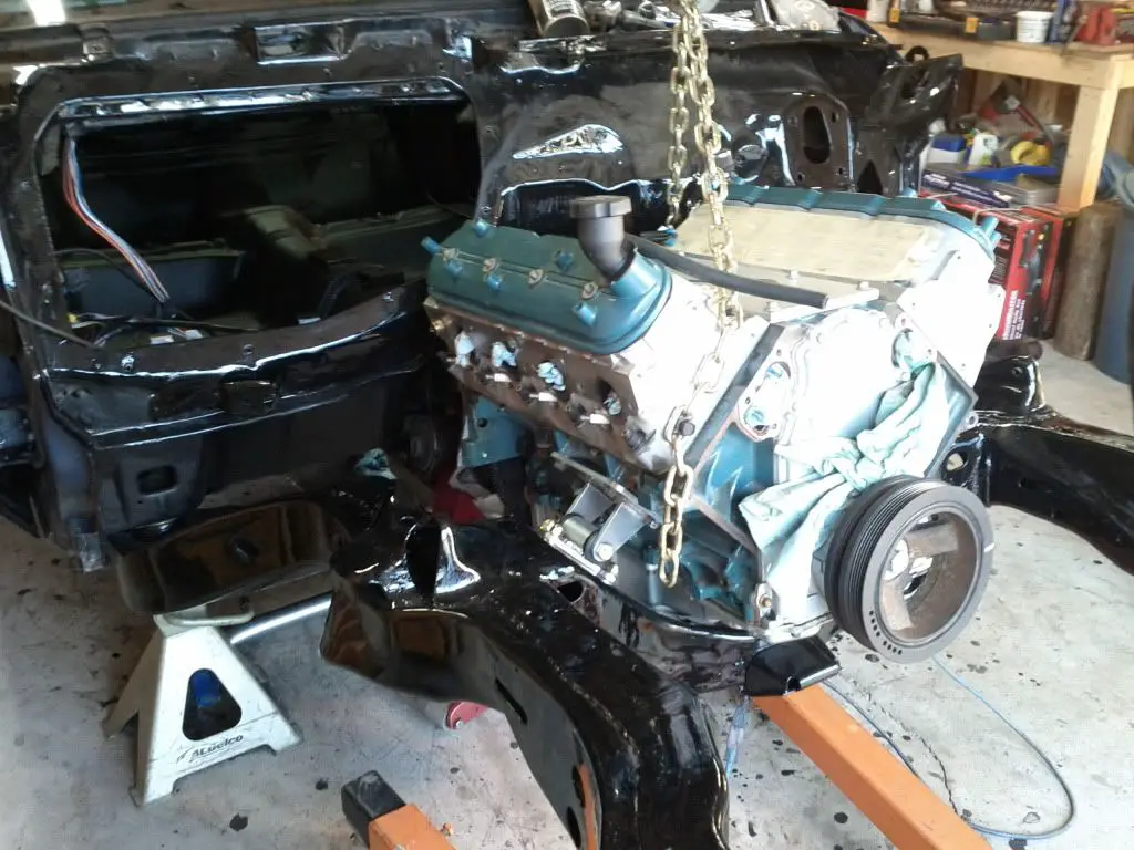

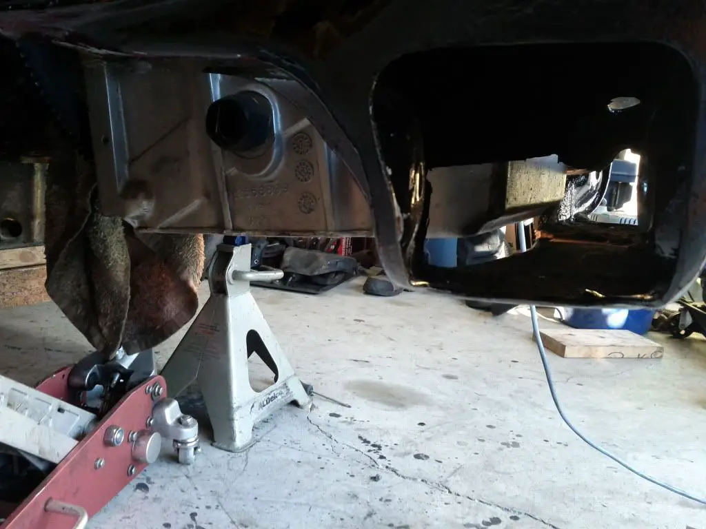

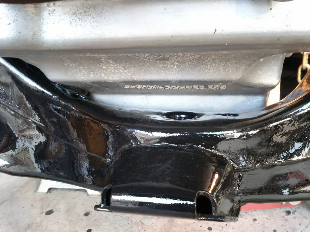

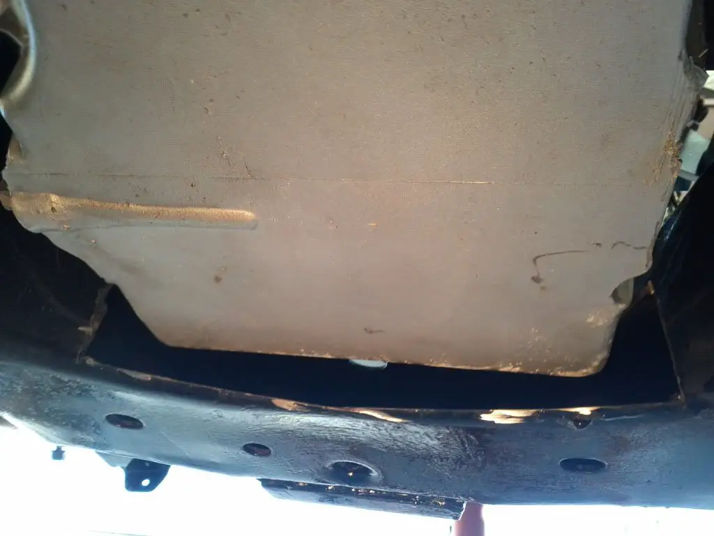

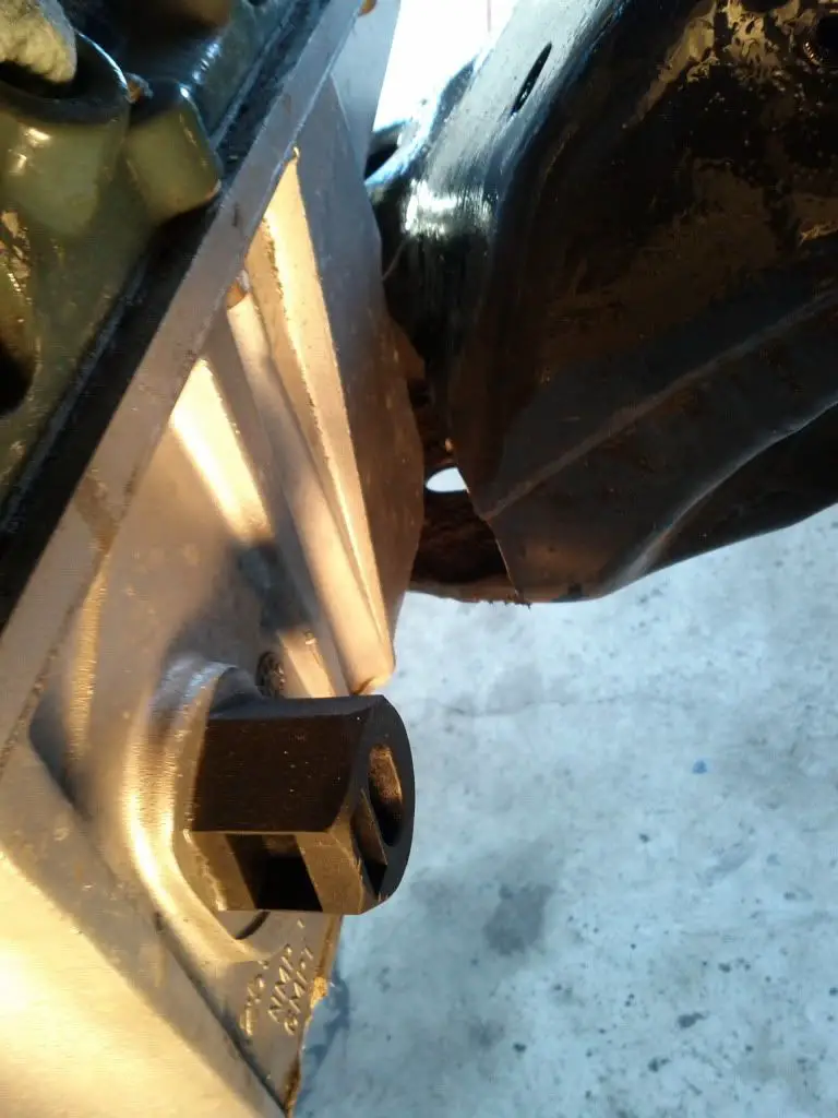

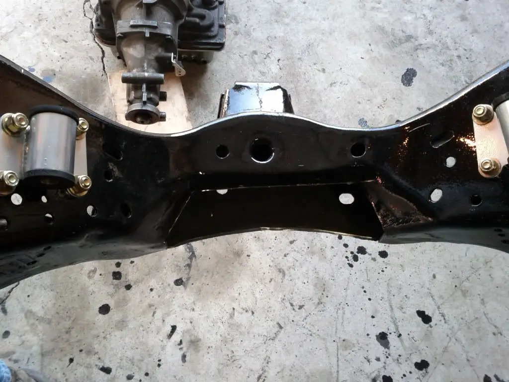

i'm working on a ls swap into a 84 ss. i have a ls motor from a f-body. i was looking at using the brp mounts, since the accessories work, and i wanted to keep the ac box. i see they say to use the lh8 oil pan. i'm not really comfortable with it hanging below the frame. did some searching and saw people use the cts-v pan. its pretty similar to the f-body one, has anyone used the f-body one? got an pics of where to cut/notch the frame?
