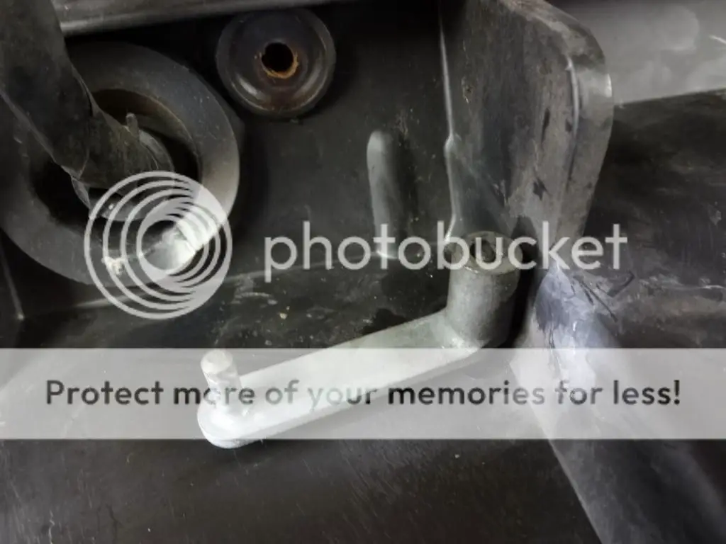

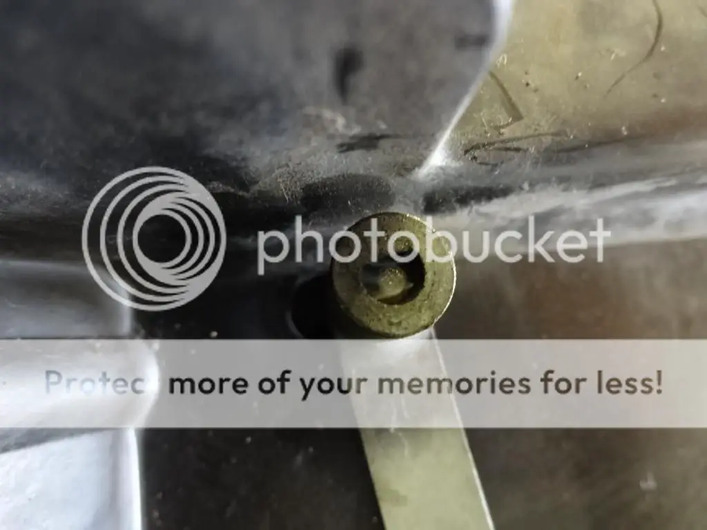

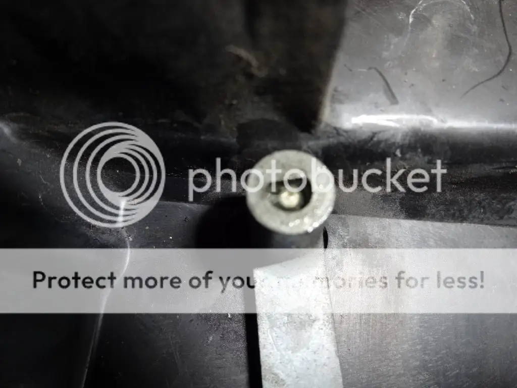

I am trying to disassembly my heat-only box and having some difficulty. It needs to be completely disassembled to thoroughly clean, because it was inhabited by mice and smells bad.
A lever for one of the doors needs to be remove from the door in order to separate 2 halves of the box. The hole in the lever is D shaped, so I am assuming it is pressed on.
I have read that some of you have disassembled your heat-only box. How did you remove this lever from the shaft?
Here are some pictures. There is a drop of WD-40 in the end of the lever.

A little heat did the trick. I used the small nozzle on my Mapp gass torch and bent a piece of sheet metal to protect the box from the heat. After heating with a small flame for a short while, it easily pried off with a flat screw driver.

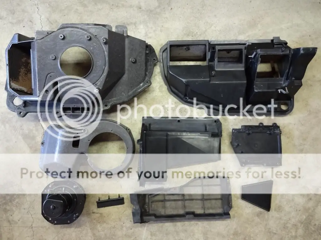

For the benefit of this forum and others who want to attempt to disassemble one of these boxes, here are pictures of the parts after I had cleaned them (the top screen was not cleaned yet)
I have removed all of the rotten foam from the doors, but haven't yet applied new foam.
