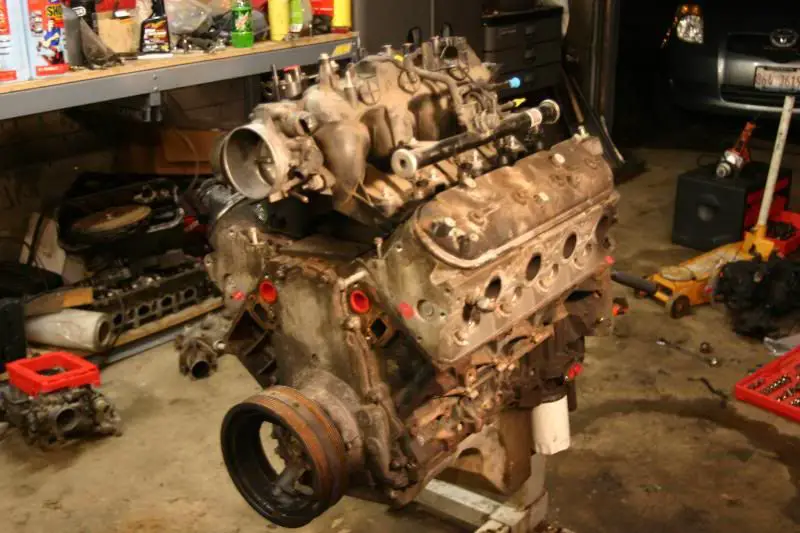

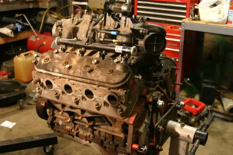

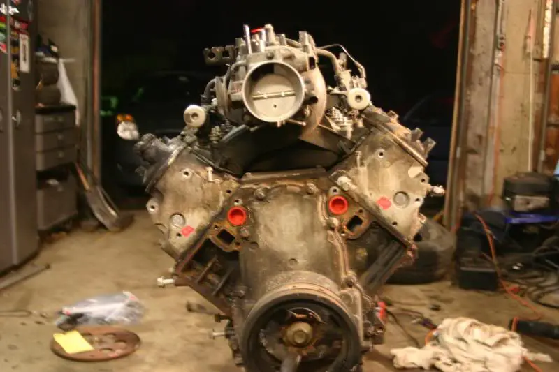

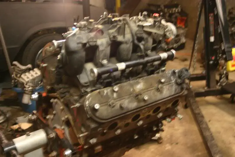

I got this one off of ebay, it had a top fire and the intake and some sensors got burnt. I asked and called on it and got as much info as I could on it. So after some thinking i bout it for $600 and it was a Hundo shipped to my work. So ebay has some and ive found some on craigslist.pmgm said:Where did you get your 6.0 from? Im in the process of trying to find one for my swap and wondering where to look....

lol thats what i said, when he told me $50 complete i was like sold man take it out the truck lol.79loserbluebu said:Yeah the truck engines are pretty bad with that and they love to have problems with oil consumption. The truck intake you have was a steal! The LS6 is slightly better with a dyno tune but like you said, the truck intake has gobs of torque and at 50 bucks for a complete setup, you can't even find a set of injectors for $50. The 317 casting heads are definately the ones you want if you are spraying the car. Doing anything to the bottom end or keeping it stock?
my80bu said:talked with a good friend of mine who knows his LS1 stuff and he said to keep the 317 heads that for the money ill spend on a set of 243's i wont pick up much. Plus i plan on spraying the car so it will help with that. I was thinking about shaving the heads but if i do that then i have to run a smaller cam to compinsate for the material i take off the heads. So it looks like ill be running a pretty much Cam only LSX which might not be a bad thing cause I have a real good buddy who can tune.

just a couple things I'll comment on here....
1. These are 15 degree motors, clearance is not really an issue...I have a .650/.609 cam in my 6.0 and the heads are shaved .20 and still have room..With a nitrous combo like your wanting I'd rather have the 243's to bump the lousy 9.4 compression a lq4 has up. Do you get on LS1tech.com? If not you need to. I don't see any aftermarket companies selling ported and milled etc 317's, but you'll see a ton of 243 casting heads for sale that have been worked on any site. If you decide to keep the 317's it will still perform I went 10.70's with no tune on a 150 shot and a ms4 camshaft in a full interior 3480lb malibu...
yeah i talked with them today and im sending pics of the engine to see what will happen. I think a refund will be coming and Ill keep the motor. I guess from what they were saying its cheaper to eat this one then it would be to send a good $1200 motor to me rather then refund the $600 i spend so we will see what happens.Brown_Gbody said:Bummer.... ](*,) Well, hopefully this will work out in your favor....
