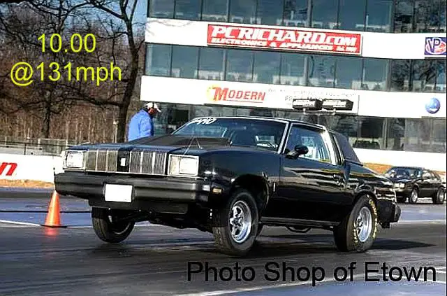

There are pics of 2 different cars ( Grand Prix and Cutlass) that I posted.
Not a rollcage but a rollbar.
But to answer your question, the pic of the rollbar is in the Cutlass that got the "bumper" brace also.
They don't leave much more level then this!
thats with no ARB?

Jordan81, no ARB per se.
I adapted an Fbody bar to the rear.
Read here: http://www.maliburacing.com/forum/viewtopic.php?f=2&t=75929
As far as wheel back spacing. The notch is the pictures on my GP.
It is a 68 12bolt with aluminum drums (they are thicker).
With 6.5 back spacing on a 15 x10 rim, 29.5x10.5x15 slicks tuck in just fine.
May be able to get more tire but have to finish it first!
