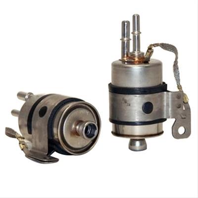

Scenario 2,iv been reading about a vett filter/regulator.so if i get returnless rails id just run feed from this filter/reg and a return from the filter /reg to the cell??and dont need a separate regulator because its part of the filter/regulator????
Whats the vett regulator set the presser at ,does any one have the part number for it if this is the best way to go..and how far should this be mounted from the cell?? thanks for the help
