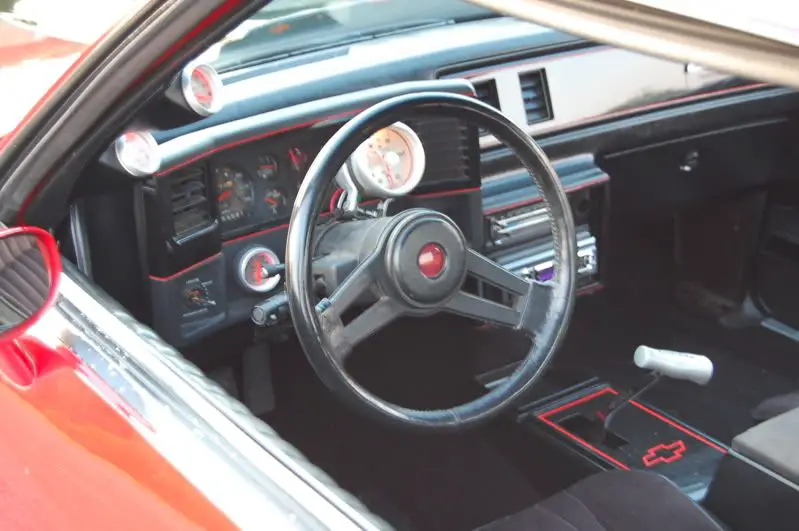

Rob on mcss.com had one with the console. But I never did ask him what all he used. Here is his:
