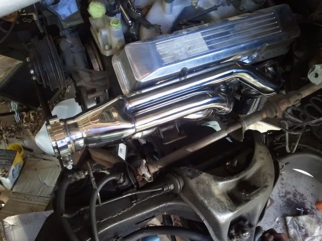

heres a pic of the passenger side header he started today, If your in the dfw area he can build you a turbo kit aswell many more pics and updates to come....
