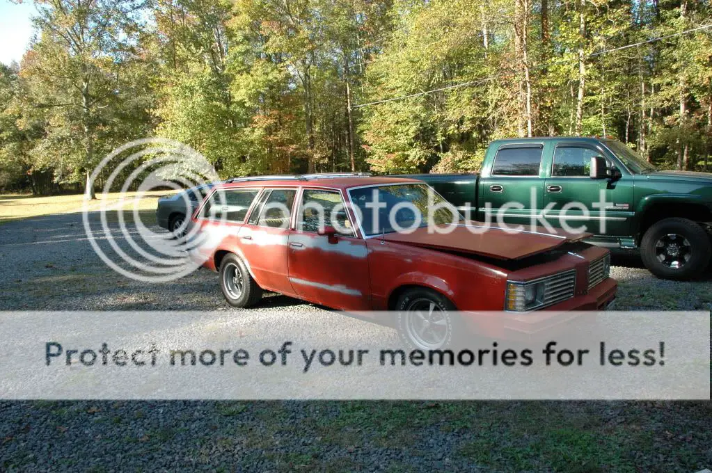

But it lowered my car more because i'm iron headed big block and all steel front end.
the picture is my wagon with 235/60/15's. it tucks the top of the tire a hair and I rub just a tiny bit only at full lock.
