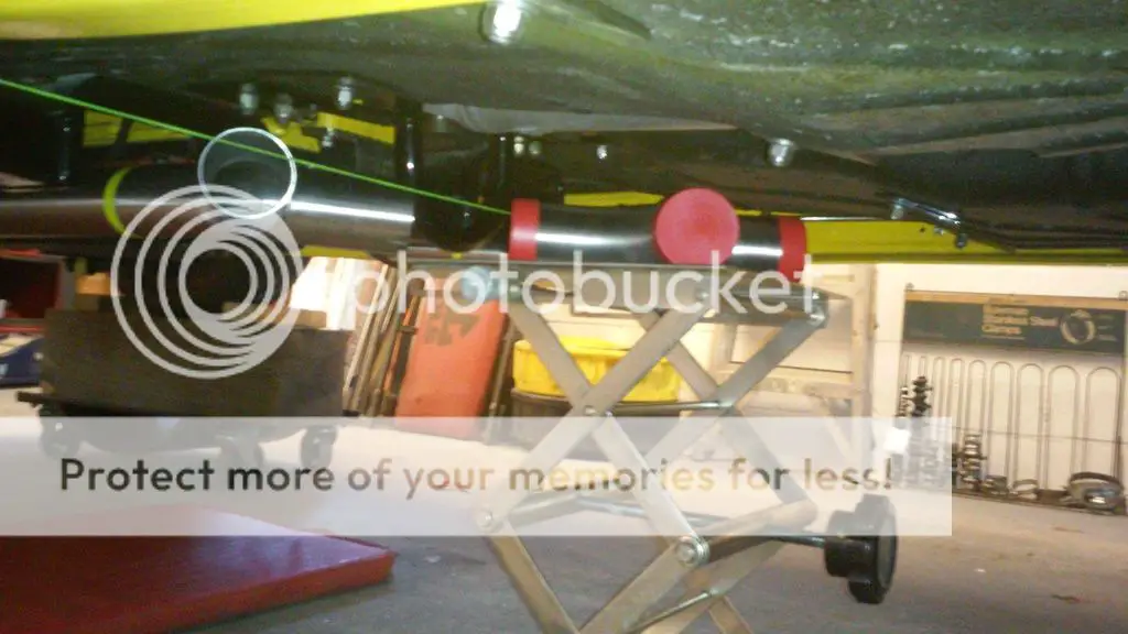

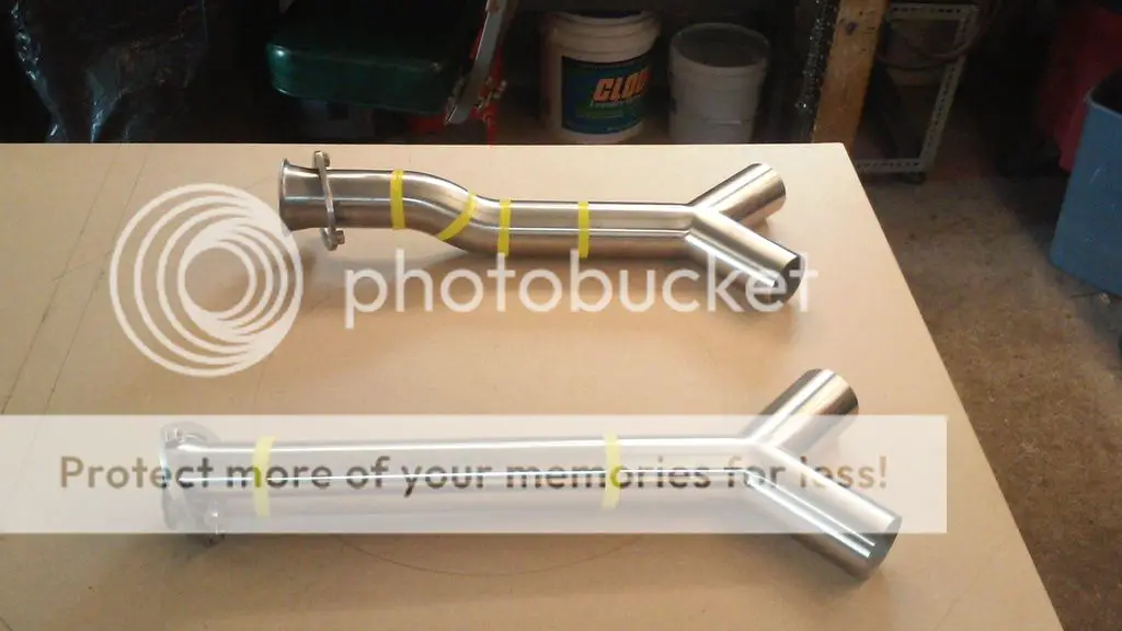

a little more exhaust work this week.that little jack makes all the diffrence.
