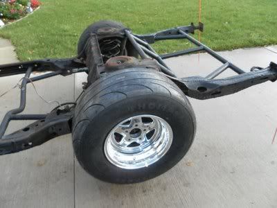

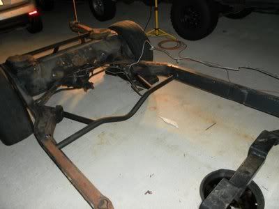

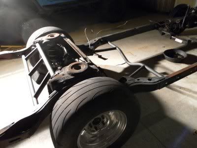

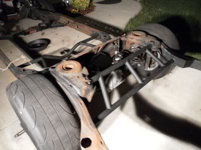

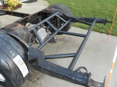

you could always do like this guy
looks like that guy moved his gas tank for that mod also.looks good none the less :)
