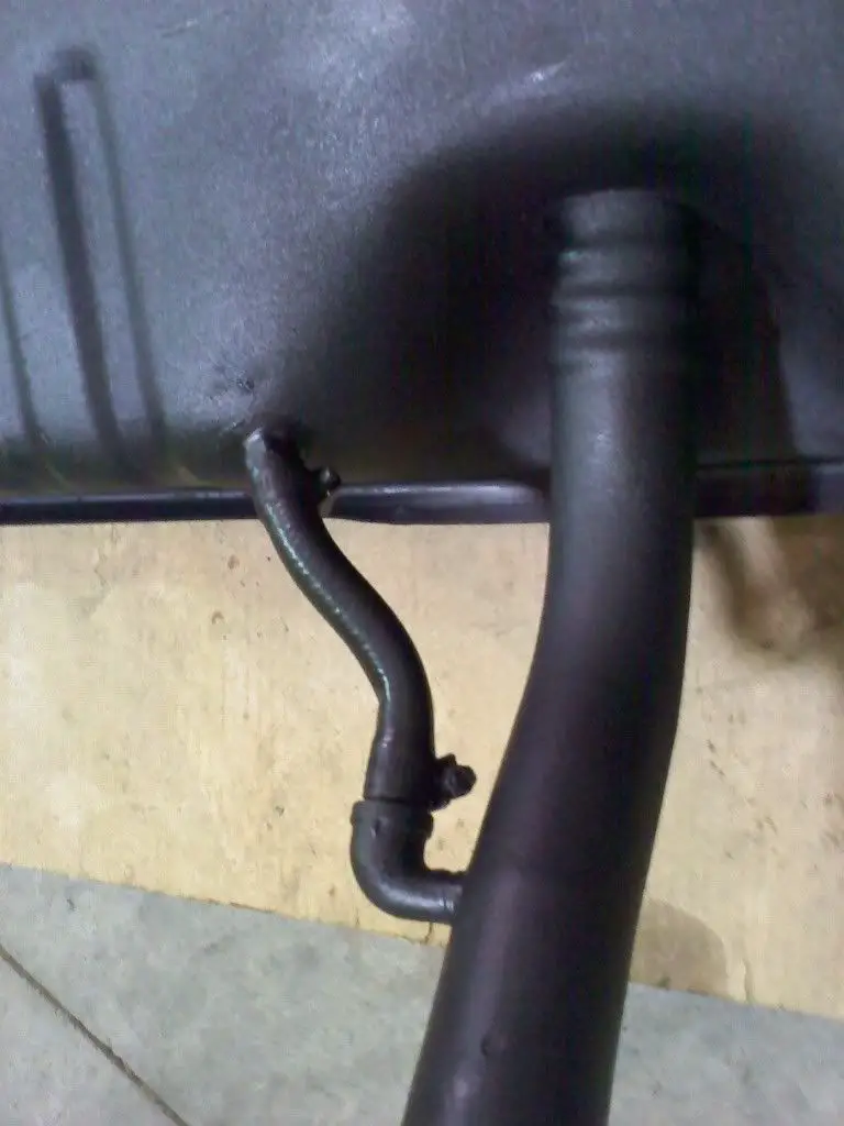

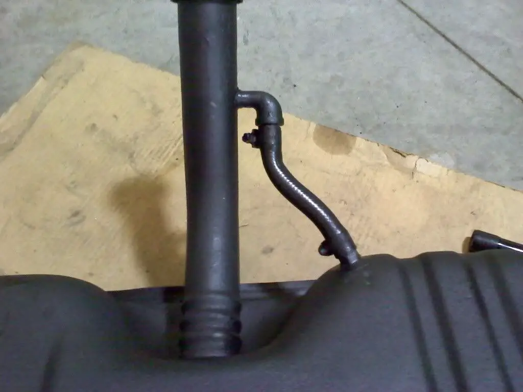

I had the same problem last summer filling up my tank. Very annoying to say the least..Here is what I did and so far so good. Just waiting for the snow to melt ](*,)

I feel ya. Pretty pathetic they cant make a tank with modern technology that vents as good as factory did...
If you are taking your tank down, I would also eliminate the restriction in your main feed line on the sending unit....And also upgrade the wires ;)
I dont know what kind of HP you're running, but I was dropping off fuel pressure under load so thats why I did all of that.
