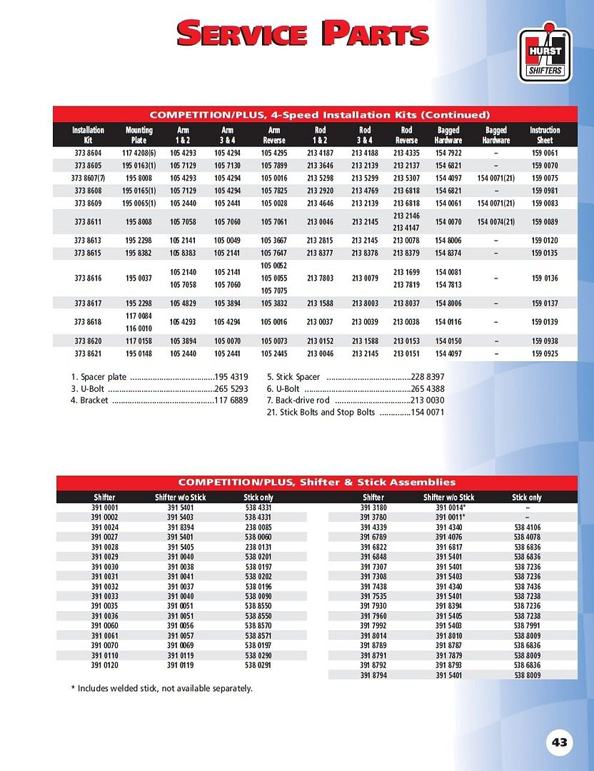

Application info for G-Bodies:
Code:
Shifter with appropriate stick:  391 8794
Shifter installation kit:        373 0017
Shifter body:                    391 5401
Stick only:                      538 8009
The '74-'81 F-Body with a T10 (w/o console) uses the exact same shifter body and stick, but uses installation kit 373 8609 (if you're swapping a BW T10 in).
The '70-'72 (no '73 listed...???) F-Body with a Muncie (w/o console) uses shifter 391 6848, same body but uses stick 538 6836 (538 8009 can likely be used since it's the same body), and installation kit 373 7897.

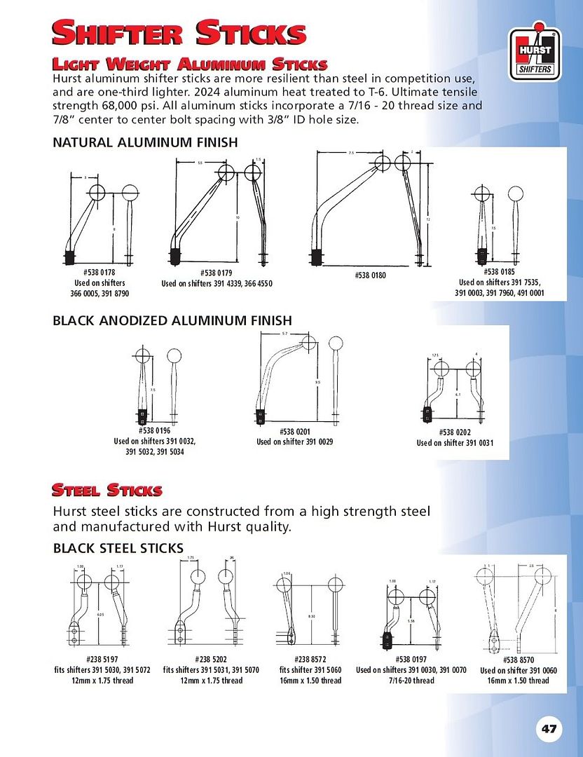

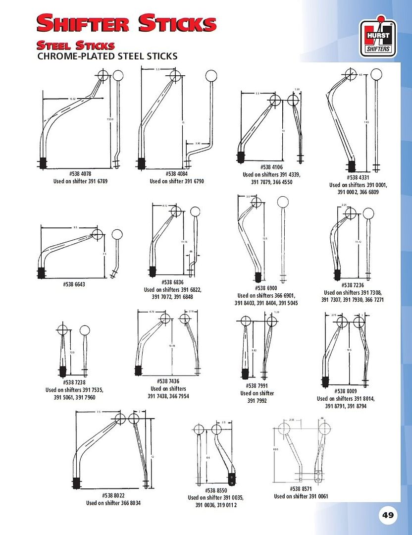

Personal preference really.........the 8009 puts the shifter ball in easy reach - right off your knee, looking at the diagram - the 6836 moves the ball over approximately 1".
Six of one.........!/2 dozen of another.
-Bill

You can mock up each shifter shape with coat hanger wire and determine which you like better.
 Post Posted: Tue Nov 29, 2011 10:29 pm
Posts: 14755
Location: Catalina, AZ
Personally I'm getting the more-left-oriented shifter handle. Right now I have a cheapy I cut off of an old Mr. Gasket shifter, and it's uuuuuuugly.
