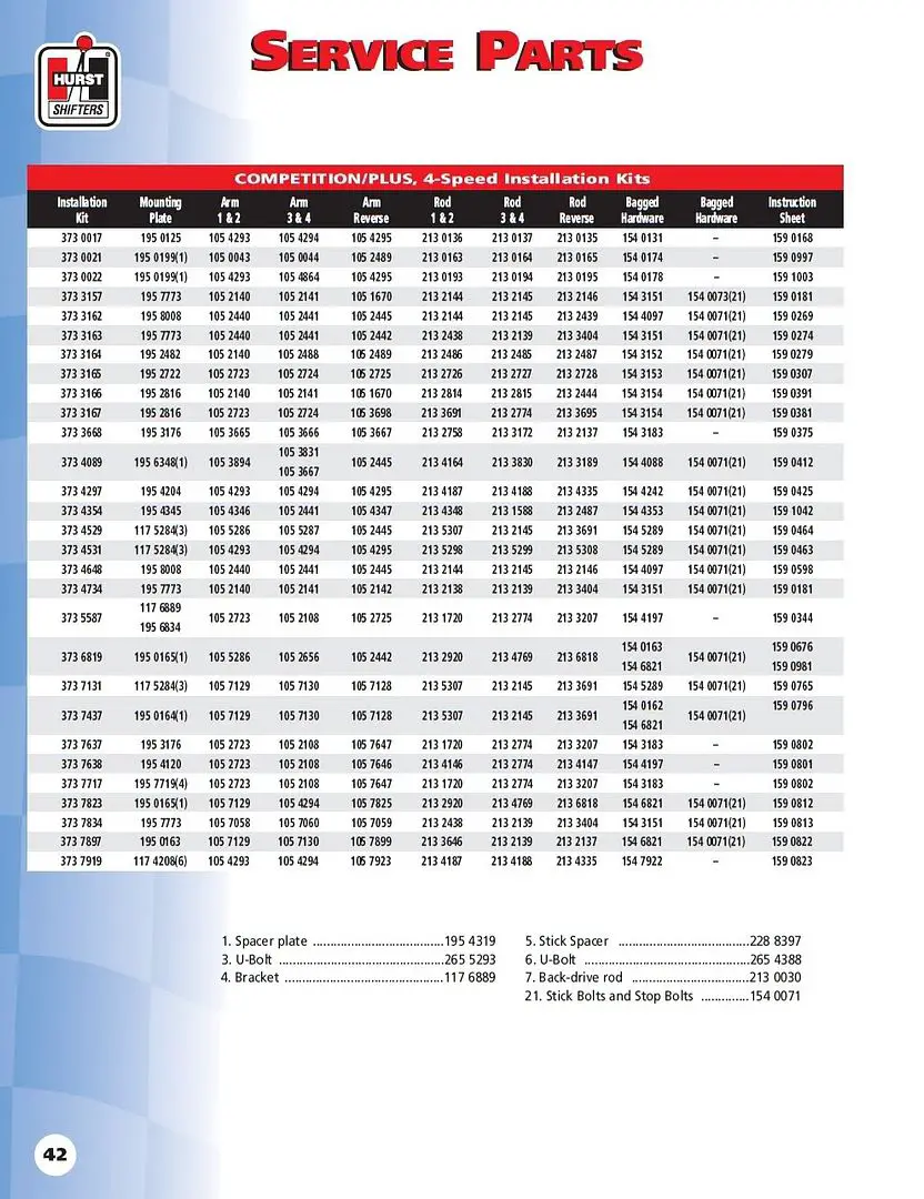

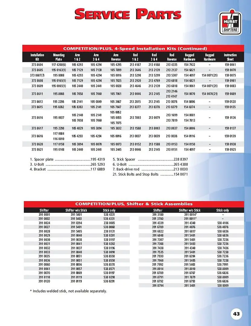

Application info for G-Bodies:
Code:
Shifter with appropriate stick:  391 8794
Shifter installation kit:        373 0017
Shifter body:                    391 5401
Stick only:                      538 8009
The '74-'81 F-Body with a T10 (w/o console) uses the exact same shifter body and stick, but uses installation kit 373 8609 (if you're swapping a BW T10 in).
The '70-'72 (no '73 listed...???) F-Body with a Muncie (w/o console) uses shifter 391 6848, same body but uses stick 538 6836 (538 8009 can likely be used since it's the same body), and installation kit 373 7897.
