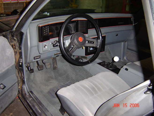

MD, your car is looking good.
You can see the difference in shifter location between the Keisler kit and the generic swap TKO in these pics.

can you tell me how you got your clutch pedal to be the same hieght/location as your brake pedal? My clutch pedal sticks out WAY TOO FAR. I want a nice clean look and not huge pedal travel. As it stands now my pedal travel is just plain insane. And if I adjust the linkage then the neutral safety is constantly on.

My flasher relay clears fine. It's the short round kind that the factory uses. Try swapping it for the plain style and see if it clears????
Clutch pedal just ended up there when it was adjusted properly. Does yours have a hydraulic? Mine's mechanical, and the pedal's gotta be to the floor for the start switch to activate, so something sounds fishy about your adjustment, the switch, and the clutch. If it's mechanical clutch, are you 100% sure the fork + throwout bearing are clipped together the right way? Lots of people do it just a tiny bit wrong, which results in the pedal being a bit funny. Just guessing here, not trying to insult your skills.
