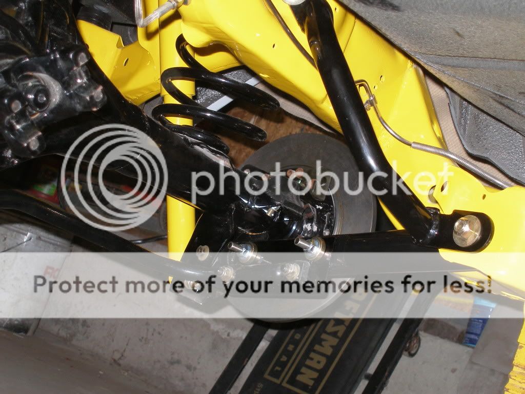

don't know if this helps much but the stock mounted rear bar rubbed my 9" and it was the smaller 3/4'' gm bar.i tig'd up some brackets to make it work but eventually switched to umi's Chassis Mounted, Pro-Tour bar. Image

that's frustrating,here's an older and the only picture of my anti roll bar.it actually lands behind the housing at ride height.my oe bar was still centered but was against the bottom of the housing.mine is offset as well.Image

thanks,it looks a lot better than that now but that's the only pic i have on my pc.i'll snap a ride height pic this weekend if need be,that's umi's Pro-Tour bar.and yes there's a little side to side.i think we've all been there doing things more than once to get it rite,i know i have.
