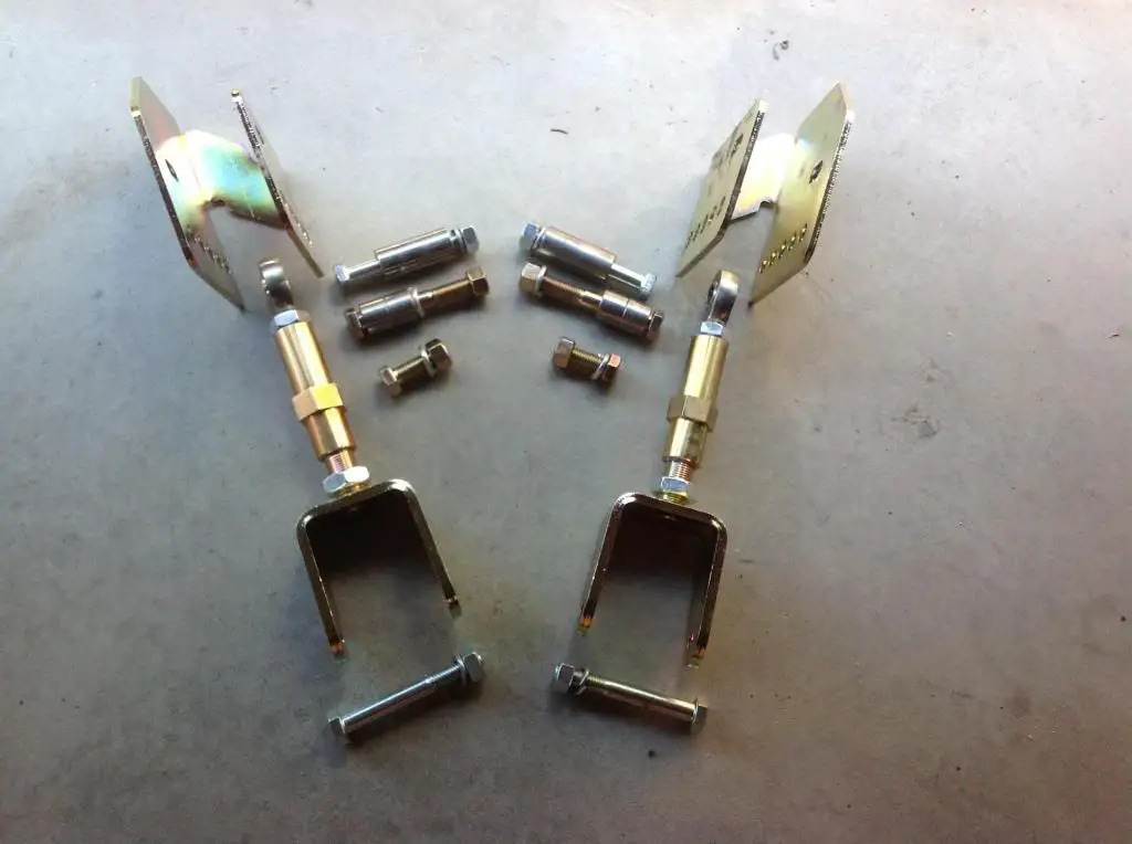

Fast forward to 2013, I was looking to get something better and more stout that could handle more power, and had trouble finding a more race type control arm. There are some other 12 bolt swap upper arms out there, but they are limited to just having the ability to adjust the pinion angle. I came across Kevin Slaby and his company Baseline Suspensions, I had heard his name mentioned on many message boards with a lot of positive comments and proven track results. I contacted him and he told me about a new kit he was coming out with that would work perfect for my application and give me some additional adjustability.

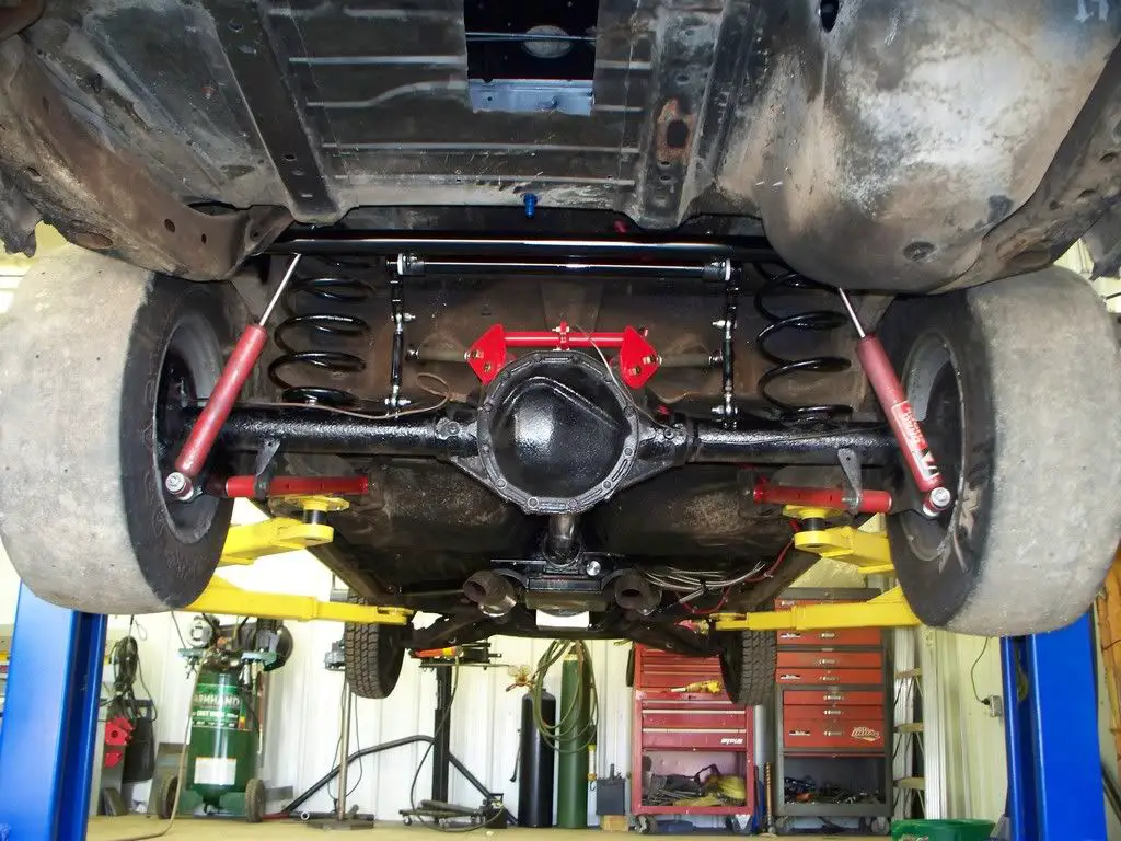

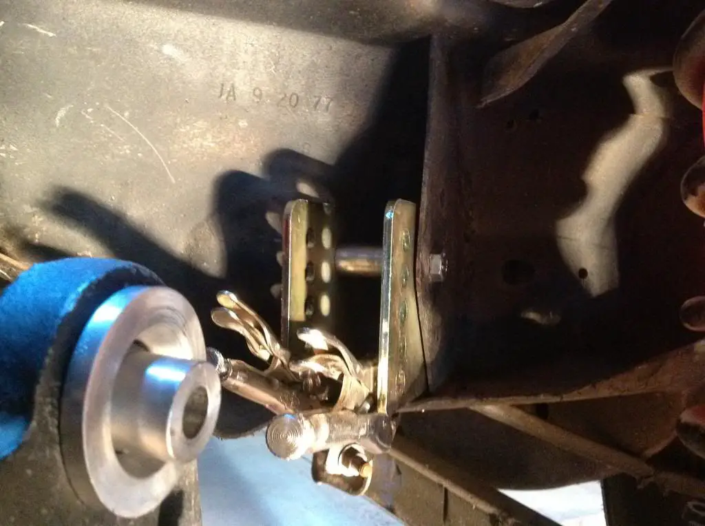

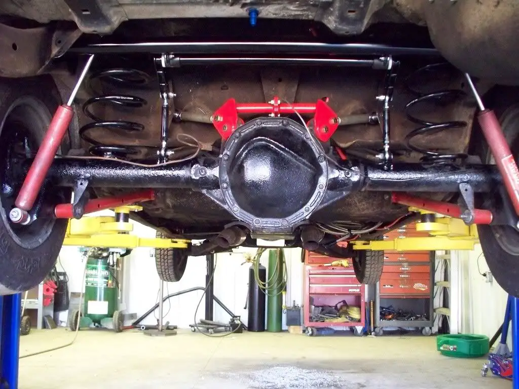

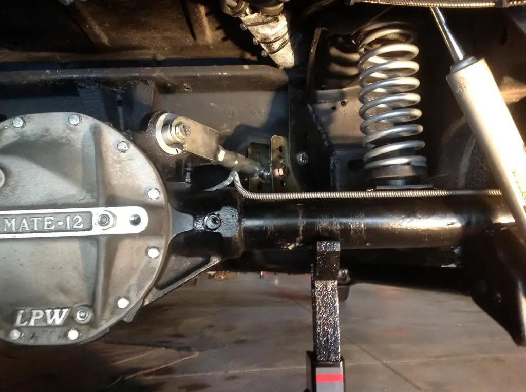

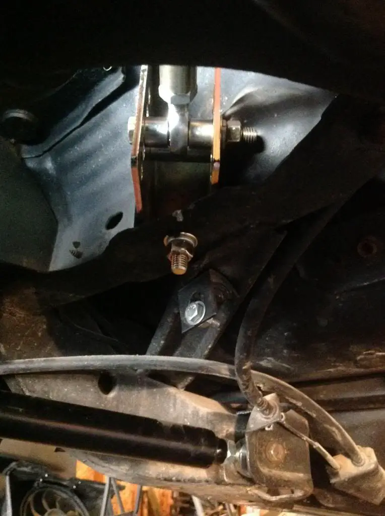

I received the parts and was immediately impressed with the quality and fit and finish of everything. High quality materials and components, good install instructions, and very good fitment of the parts into my car. He also provided excellent tech support, and was always more than happy to answer my questions quickly and with a precise and though out answer.

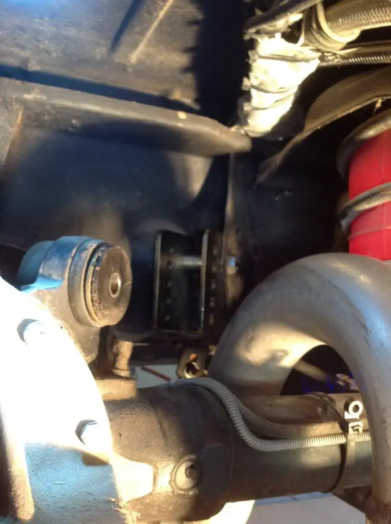

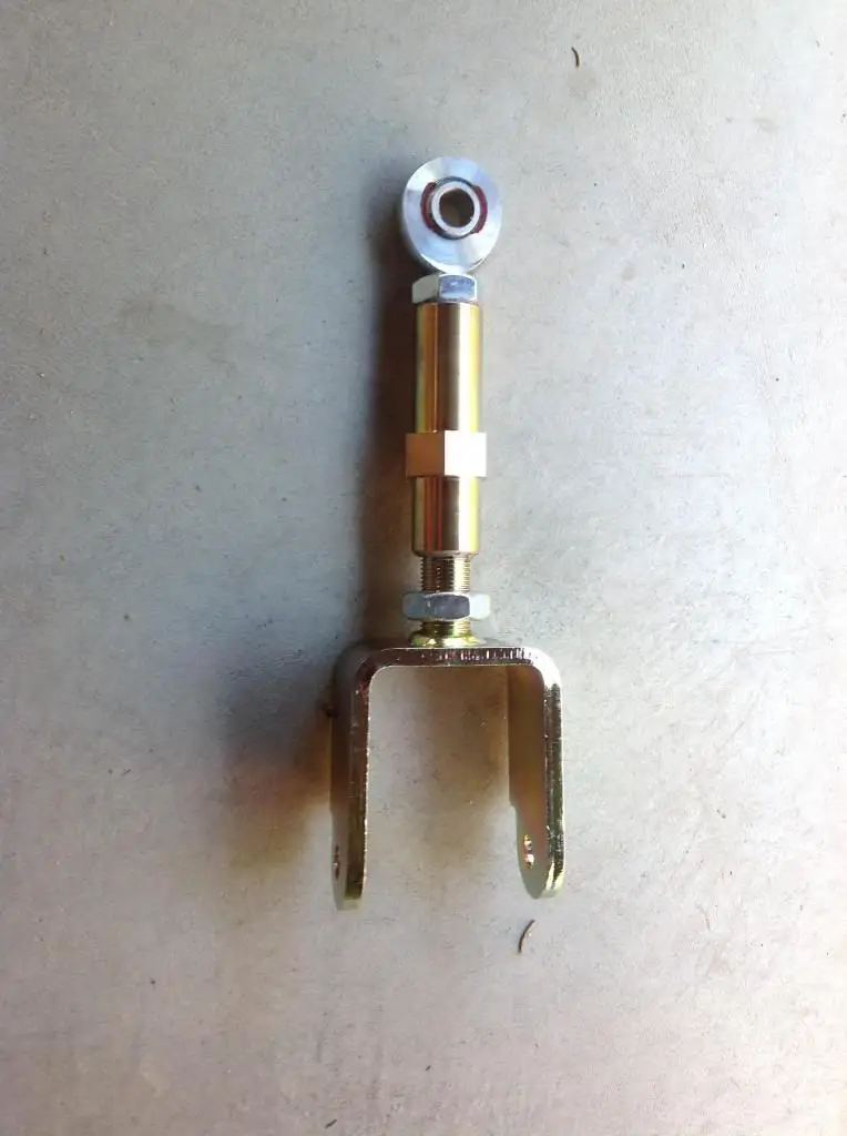

The following are some pictures of the install and the finished installation.
Couple of things to note about the kit, installation and my car:
-You will need to get spherical housing bushings in order to use this kit (I got TRZ bushings)
-I added adjustable spring perches from TRZ to be able to change the ride height of my car
-In order to get the correct Instant Center and Anti Squat % the lower control arms need to be parallel to the ground or very close.
I have yet to get the car to the track to test this kit, but I will follow up this thread with testing results from the track.
