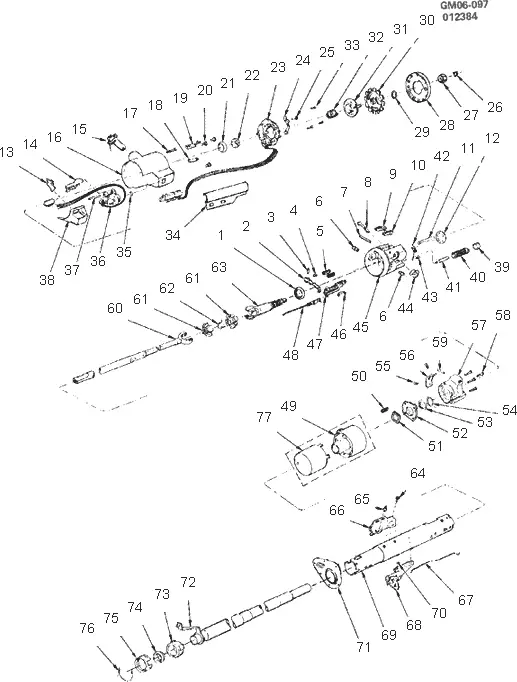

I bought this column a few years ago from a local column shop, no steering wheel or lock collar. The tilt is still tight, but the upper 'stub' shaft wiggles around. Could this be due to missing bearings in the tilt section?
http://www.steeringcolumnservices.com/gm-buick-cadillac-chevrolet-oldsmobile-pontiac/bearings.php

There should be no wiggle. There are 2 sets of ball bearings supporting the upper stub shaft.

Is the steering wheel lock plate installed? If not, then I can understand the wiggle. Beneath the plate is a spring that presses on the upper race.
If the lock plate is installed, there is something seriously wrong.
