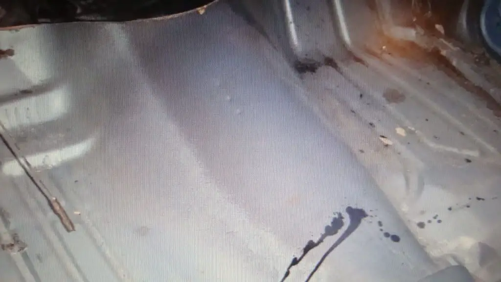

Not sure I can help with exact measurements,I did this once before and I just went to a car that had the buckets and console and transfered the measurements over to my car.I can tell you that on the transmission hump,up towards the firewall there are three small dimples already on the floor from the factory.That is where the shifter cable goes through.The dimple in the center is for the cable and the two outer dimples are where you put the screws that hold on the rubber boot around the cable.If you are able to lift up the carpet,you should see them.They are not in the center of the hump but more towards the driver side.Im not positive that those dimples are on every gbody made,but they were on the malibu wagon that I installed the buckets in and they are in the malibu that I have now.Maybe that can give you some reference.
