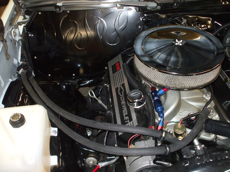

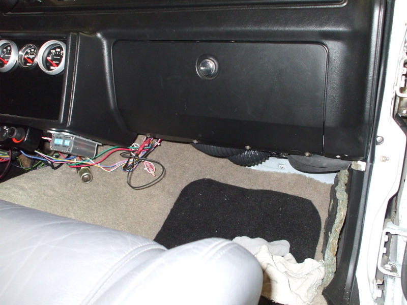

I'm installing a heater with defrost in my '79......the September and October evening cruises are getting to me in my old age:
I wanted to try and use the factory defrost vents, so I fabbed up this 'plate' to connect the defrost ducts to...
I snaked the hoses through the opening in the door jamb......no way I was putting holes in my 'flamed' heater delete panel.
Here's a link to the album....
http://imageevent.com/weirtonspeedandma ... stallation

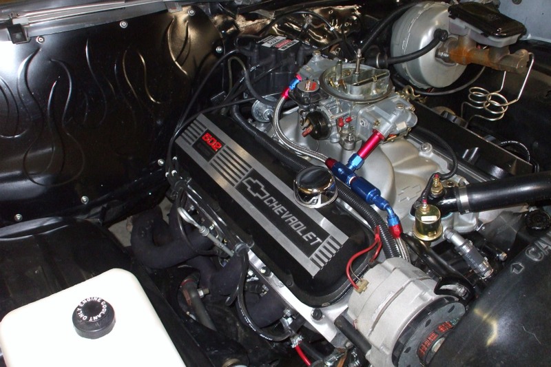

The firewall will look like it did before the install, the only difference under the hood will be the heater hoses.

NO........what you see under the dash is it. The only difference under the hood from this photo will be the heater hoses.

#### I may have to consider this. My 1uz swap is cutting it close to the heater box...i can make it work, however I like that cleaner look.
Does it operate off the stock controls?

No......it comes with a three knob panel. I mounted mine under the dash, not crazy about the look, but........

Someone smarter than me in electronics could probably figure it out. The fan switch for sure, the temperature control and heat and/or defrost are both electrically controlled.
I thought about not mounting that panel and just tucking it up out the way behind the radio when not using the heater, but.........probably just 'hide' it with a black hand towel during cruises. It is ugly.

Finished.........need to tie up a couple loose wires and wait for October!
Standing outside the car or seated in it, the heater and ducts are not visible - what I was shooting for.

Did you route them through the fender and door jam?
1980 Malibu BBC T-56 9"
1986 Oldsmobile Cutlass.
 Post Posted: Wed Apr 26, 2017 1:06 pm
Joined: Thu May 22, 2003 6:27 am
Posts: 1160
Location: WEST bygawd VIRGINIA <26062>
Yes.........through the hole already there.
