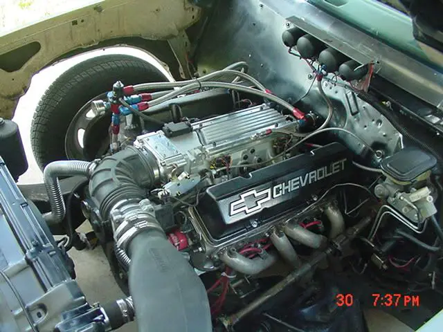

You will need one of the aeromotive regulator, either the one the fits the stock rails or i do what id and have some bungs welded onto the stock rails (see my old pic)
