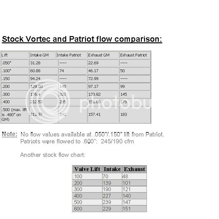

Unless you can get Vortec's CHEAP, the mods required to make them survive with bigger valve lift, a different intake, valve covers, etc. really add up, dollar-wise, to the point that considering aftermarket heads is a viable choice.
Here's a nice comparison Vortech to aftermarket:
http://www.2quicknovas.com/vortecheads.html
I've toyed with Vortec's for a LONG time but their purchase, upgrading to a stainless valve package, adequate valve springs and refreshing a set of used heads makes these a logical option.
The Patriot "vortec" 185's outflow Vortec's on EVERY level and still retain the Vortec's chamber and awesome port velocity you want on the street.
They come with all the goodies (stainless valves, plenty of lift clearance, great springs, retainers, etc.) in a lot heavier duty casting as well.
They're $695 delivered on Ebay every day.
See flow charts below comparing stock Vortec's to them.
Here is a link to Patriot's site for info on them:
https://www.patriot-performance.com/xca ... =76&page=1
The 906's are not a better flowing "version" of the Vortec.
The 906's actually incorporate an added casting below the exhaust seat (heavy truck application?) that needs to be addressed to bring it up to 062 spec.
I'm sure a lot of you remember when the Vortec's were $250 a piece complete.
Those days are LONG gone.
They've gone up a LOT ($300/ea.+). :(
