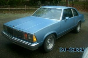

I've got an 80 malibu with a 327 and m20 4speed, i just put a new quicktime performance 9 inch in and drove it down the road. Its developed a squeking noise from the driveline and first thing that came to mind was u-joints and i replaced then and squeking still continues, any ideas would be greatly appreciated. :-k
