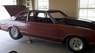

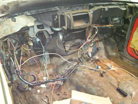

Not much, but I'm starting to get the interior back together. Here's a before shot:
Here's what it looked like today before I got started:

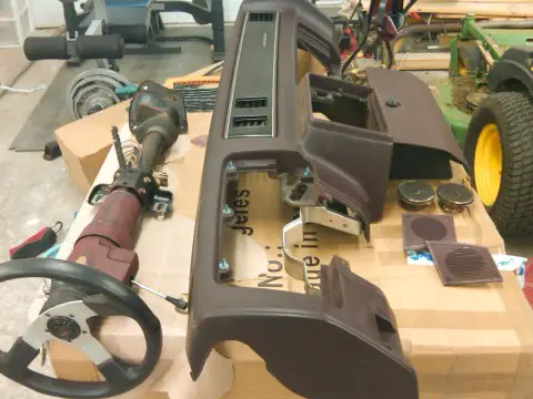

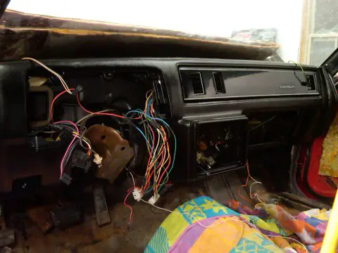

My son wants the interior to be black. So, here's the parts I needed to dye black:
Here's the dash installed after it has been dyed black:

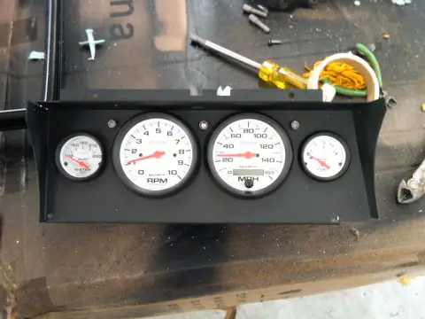

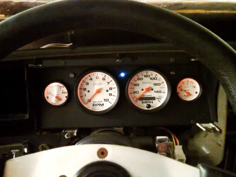

If you remember from WAY back, I purchased Autometer Phantom gauges. They are installed in a custom gauge panel, here's what they look like:
I'm mounting the oil pressure and volts gauge in the gauge panel cover (bottom right-hand-corner). See below:

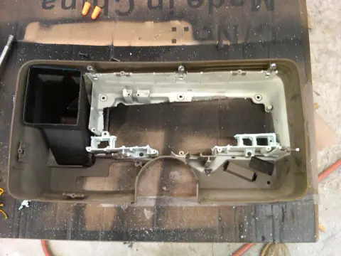

I had to break out the cut-off wheel and hack-up the factory gauge cluster backing to make room for the speedo and tach. Obviously, the gauge cluster is not re-usable after these modifications:

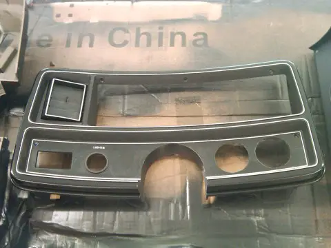

Here's a shot of what it will look like when installed. Notice the oil pressure and volts gauge in the lower-right-hand corner. If you look close, you will also see a small LED between the two gauges. This will be the "check engine" light. I will mount the OBDII connecter below the dash to retrieve codes.
Here's the gauges installed in the dash and connected. Everything is working and looks really good if I do say so myself. You can see the high beam LED on in this shot. I don't have the oil pressure and volts gauges installed in this shot. I haven't installed the gauge pod cover yet....

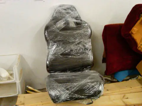

I'm off work tomorrow, so I plan on finishing the dash and then installing the B&M Hammer shifter and the seat mounts. Here's a shot of one of the seats. It's not a good picture since it's wrapped in plastic, but you get the idea, it's a Corbeau style seat.

hey that looks great!what did you use to die the dash?those gauges look great against the black backing,thanks for the update.
rotisserie-mod
82 el camino
406/200r4
 Post subject: Re: Update 11-11-09
 Post Posted: Mon Nov 16, 2009 12:10 am
MalibuRacing.com Founder
Joined: Mon May 05, 2003 8:04 am
Posts: 3484
Location: Decatur/Huntsville, Alabama
It's plastic/vinyl dye in a spray can. VHT, SEM and Duplicolor makes different colors. Parts stores usually carries one brand or another.

I really like the dash. I will ba doing a similar swap on my 80. Where did you get the panel to mount the tach, speedo and gauges?

I purchase a blank gauge panel from a member on this site. His username is blownbigblock (click on username for contact info).
