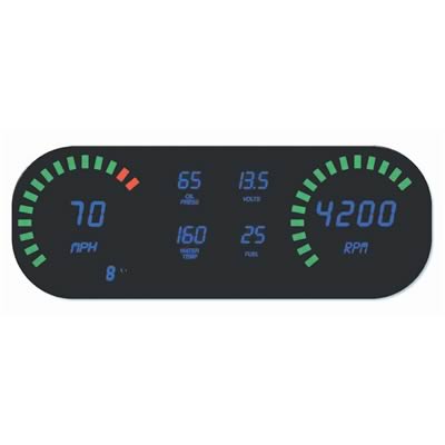

I'm leaning heavily toward using the Nordskog digital gauge package. It is a direct bolt-in replacement for a G-body, has all the gauges, turn signals, high beam, emergency brake light, etc. Since I need an "electrical" speedo (using PCM VSS signal), this makes even more sense. After pricing the gauges, then mounting on a custom plate, wiring etc., this just seems to be a nice solution. It's as cheap or cheaper than gauges, looks pretty cool and will be easy to wire all the gauges and calibrate the speedo. It also comes in different colors (red, green, amber, blue).
