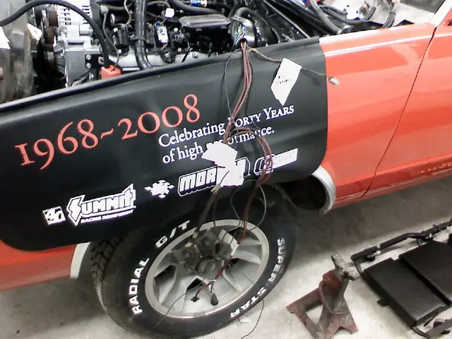

The battery will be relocated to the drivers side. I will need to figure out a way to mount the PCM on the driver's side wheelwell. I've got to run the looms behind each cylinder head to connect to the oxygen sensor on each side and transmission connections. I know, it looks like a total mess now, but I'll get everything cleaned up and tidy.

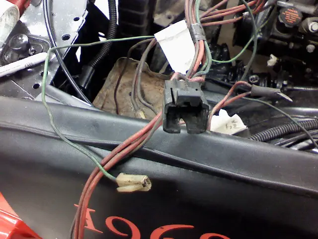

Here's the wires that are from the Malibu factory harness. They are the starter and alternator connections. I will need to figure out how to migrate this with the new harness and PCM. I plan on using the factory malibu starting circuit (obviously), but I've got to figure out how to do the alternator connections. Right now I have all the 2004 harness connections going to the alternator. But, what do I do with all the old Malibu alternator wiring? :-k Like I said, got some studying to do.

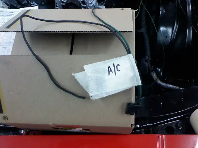

This can't be good can it?? This is the factory Malibu A/C connector. When I removed the loom, the black wire was inside the loom and not connected to anything. Is this normal? I'm guessing the compressor is grounded through the chassis? Should the black wire be connected? Gotta' look at the wiring diagrams.

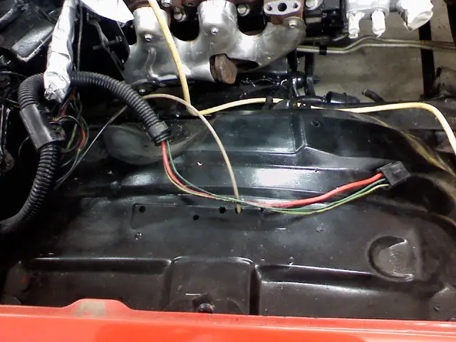

What the heck does this connect to? I'm thinking the single wire connector is for the oil pressure idiot light. The coolant idiot light connector is on the other side (driver's side). I'm not sure about the other connector. Any ideas?
What about this connector? Not sure where it goes? It's next to the A/C stuff, but I cannot remember what (or if) it connects to.

the 2 connectors you asked about on the bottom pics....plug them into each other ;) the large red is the blower motor high speed feed...the smaller ones iirc are the rest of the blower motor wires...though imo you are better off doing away with the connector...its a common high resistance spot (they melt easily)
the A/C plugs black wire you can just ground if you still need it for anything...

The green wire goes to a)temperature light switch (dummy lights) or b)temperature gauge sender (round gauge package). The tan wire would be for the oil pressure switch/sender. That stock alternator 2-wire plug is basically the same thing as the rest of the newer alternators, the larger red wire is a constant 12v feed to the alternator (so you could actually tie it to the BAT terminal of the alternator had you been sticking with a traditional SBC and shaved a little wiring out of your harness), and the other is the same as the newer alternators, a wire that tells the alternator to 'turn on' when it's energized.

As for the Alternator, if you look at the picture below, you can see that I'm using the Tahoe battery connection setup. See the little red box below and right of the alternator on a bracket. If you notice, it has a small black wire running out of it (connects to battery cable) that is connected to the battery supply of the alternator. I'm pretty sure the PCM controls excitation to the alternator, but I will ask the guy that did my harness to make sure. All the connectors are there and connected from the Tahoe harness that connects to the alternator. I just need to figure out which wires on the Malibu Harness to get rid of and which ones to keep to supply needed power for the accessories, lights, etc. for the rest of the car.

the new engine computer will control the alt, you should have a plug that goes into the alt. All you will use for the car side is the main hot wire (clumped toghter and was attached to the rear of your old alt) this will power the car fuses and accessories, you can connect that to the new alt or to that red power supply box. you will need a few hot and key on hot wires for the new compter, but you can tap into the malibu fuse panel, use the IGN and BAT spaces.
