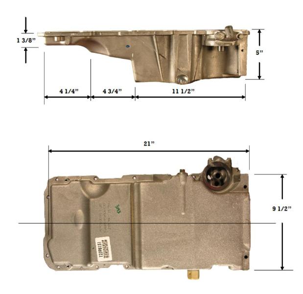

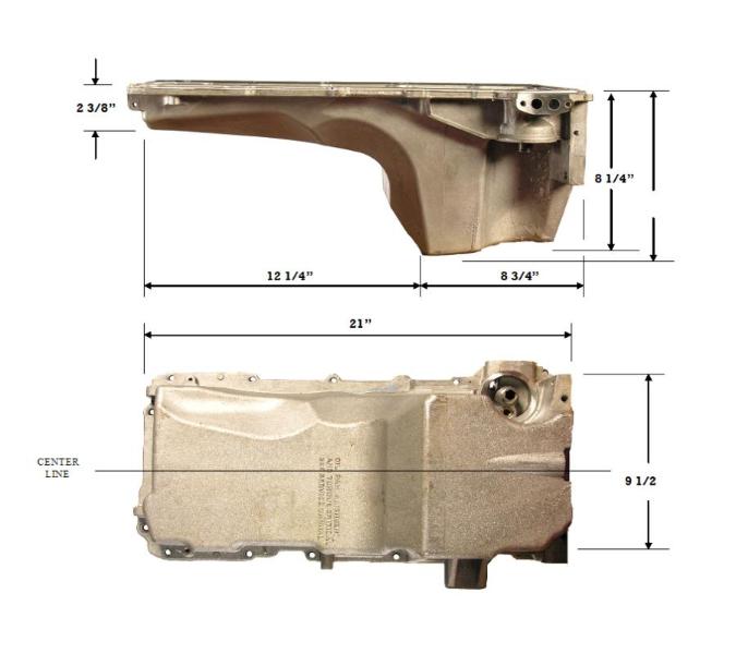

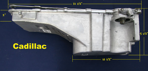

Decided to give the CTS-V pan setup a try. It looks very similar to the Moroso pan shape (no side kickouts though) that 406RollerBu is using. It is going to be about $100 cheaper than the Moroso pan setup, plus I won't have to run a remote oil filter setup like the Moroso pan requires.
So, I'm hoping that it will fit. :roll: If it doesn't I should be able to get most of my money back out of it. I ordered it today, should be in this coming Monday or Tuesday.
Here a few comparison photos:
Truck pan:
F-body pan:
Moroso pan:
Image Image Image
CTS-V pan:

Man, I had to wrestle with it to get it to seat on the mount pads. It was a pain. I could not get the motor in at all with then transmission attached. The oil pan was hanging on the crossmember, even with an extreme amount of tilt. I may be able to with the shorter oilpan. We'll see.

It didn't come in until yesterday. We tried some test fitting last night. It clears the crossmember fine. I'm not sure about how low it is going to hang at this point. When I was dropping the motor in for test fit, I noticed the passenger side frame mount was VERY worn. It definitely needs replacing. So, I could not get it properly positioned to see how low the pan will hang. I'm guessing it is going to be close to 1/2" - 1" below the crossmember, but that is nowhere near as bad as the truck pan. The front of the sump on the pan looks like it might have 1/2" clearance to the crossmember. It is very close, but it fits fine. Also, there is no clearance problem with the slope of the pan either. Again, it's pretty close, but doesn't appear to be a problem. I will know more after I get the motor mounts replaced. I plan to get it done this weekend, and shoot pictures.

With the truck pan having a sump of over 8.5" and the CTS V pan having only 5.5, thats a good 3inch difference. If it hangs down at all it'll only be an inch or so. Should give me another 3" of ground clearance easily lol.
