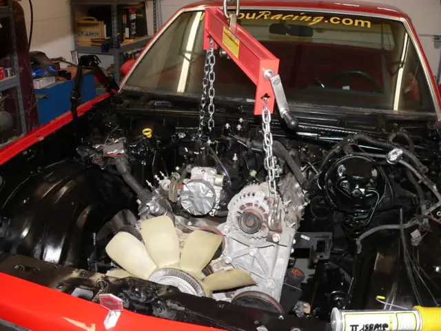

I had today off from work, so I thought I would do a test fitting to see what is what.... Here's a few pics and some details:
Here is it being lowered into place. I removed the tranny to make it easier to do test fitting.

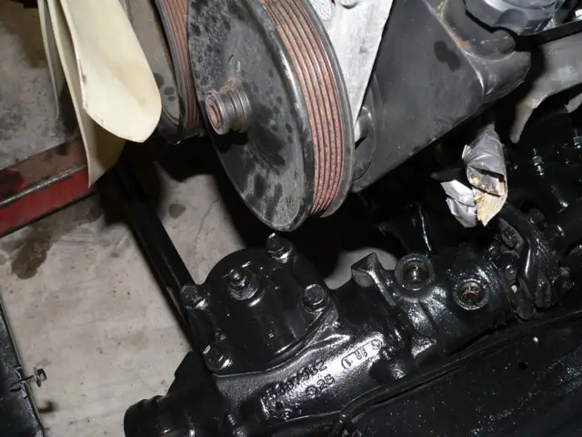

So far this seems to be the only issue. 78'Bu-88SS addressed this issue in his swap. The stock power steering pulley is too large in diameter and hits against the power steering gear box. He said that a early 90's 2.8L S10 pulley will work. I will probably be going to the junkyard tomorrow to find one.

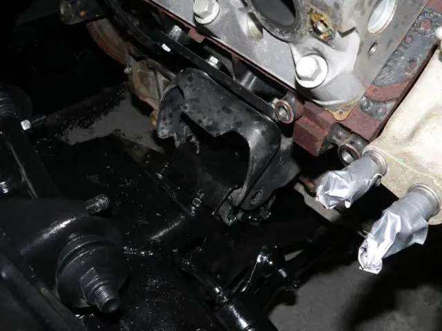

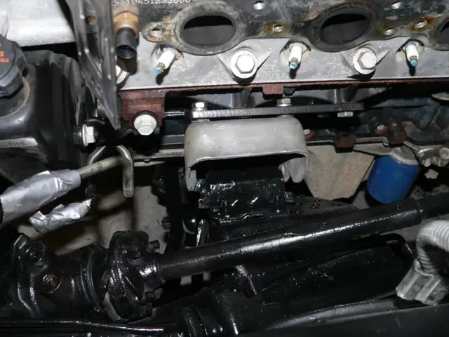

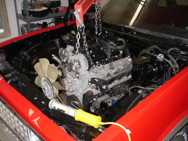

Since I couldn't lower it all the way due to the power steering pulley, it's not quite sitting on the motor mounts. Probably lacks an inch or so. This is the passenger side mount. I'm using TransDapt adapters with the stock frame and motor mounts.
Again, you can see the motor is not sitting on the mount because of the power steering pump pulley issue. This is the driver side mount.

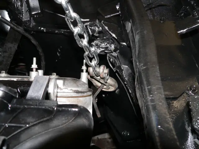

Ouch... This is where I bumped the A/C box with the engine hoist hook. Just a scratch, luckily. I mounted the lift hook on the head, but I probably need to move it to the bellhousing bolt holes to keep from interfering.

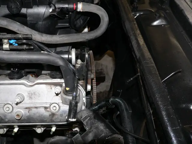

Althought it will be snug with the A/C box, I've got a lot of room between the firewall and rear of the motor. At least it will be easy to reach the tranny bellhousing bolts.

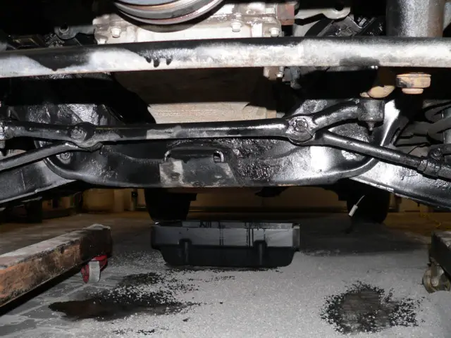

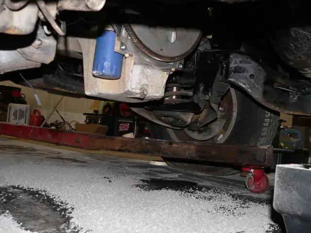

At this moment, the stock truck pan is not hanging much below the crossmember as you can see. I expect this to change when the motor rests on the motor mounts. I'll have to decide if I want to keep the stock truck pan or not after I see what it looks like with the motor resting on the mounts.
This is probably a better angle to see how low it is at this point. Again, it will be lower when I take care of the power steering pulley issue.
Semi-front view.
I removed the A/C compressor before I lowered the engine down. I'm not sure if it is going to clear or not. It looks like it might fit, but I'm not overly confident. I'll really need to get it lowered into place before I can start test fitting the A/C compressor.
I'll update when I get another power steering pulley and can fully lower it into place.

take that pulley off , bolt that motor down
mosty all gms have the same pump shaft diameters
so even a 3.4 ,3.8 v6 pulley can work
looks good

Yeah, I called a few parts stores, to ask about pulley shaft diameters. You cannot find "old school" parts guys anymore. If it's not on the computer, they don't know. Also, the depth (offset) needs to be right. It was said that you have to grind about 1/16" off the back side of the 2.8 S10 pulley to mate up perfectly.
