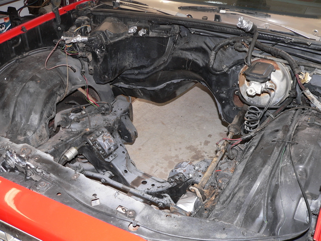

We got some done over the weekend and this evening, but nothing really to brag about. We got the engine bay steam cleaned. We have put one coat of paint on the engine bay, and need to put one more.

Preparing to paint engine bay:
After One coat of paint:
Since it's going to be my son's daily driver, I didn't go all-out on the clean-up and detailing of the engine bay. But, it will look a heck of a lot better than before. My Son was proud of it nonetheless.

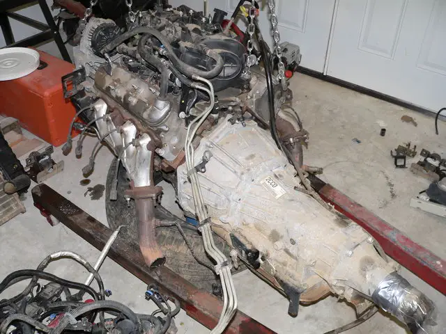

Also, we stripped the wire harness from the motor and transmission. I plan on taking the motor and tranny to the car wash and steam cleaning it sometime this week. I don't want to do it around my house, too messy. Motor and trans with wire harness stripped:

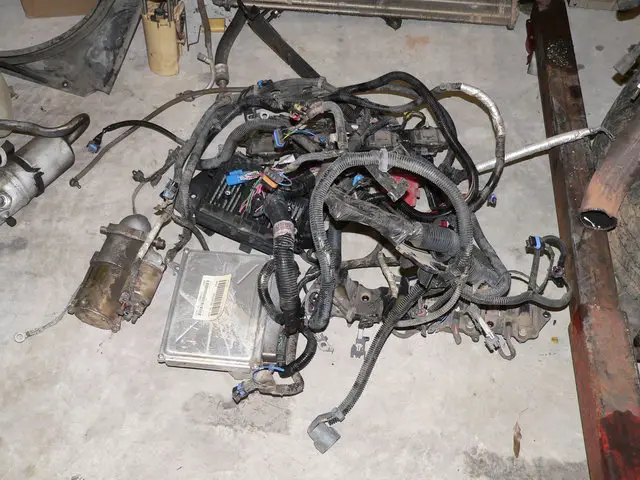

Wire harness pile:

Bay looks good, just krylon, did you prep it much? Im still debating body color vs black, but that looks good.

Really, not much prep. I sprayed it down with engine degreaser, steam cleaned it, then I used scotch-brite type pads on everything I could get to, then used laquer thinner to clean everything before spraying with glossy black engine rattle can paint. Not perfect, but it looks pretty good.
Like I said, it's going to be a daily driver, so I'm not trying to get a show car quality finish. But, both my son and I are happy with the results.
