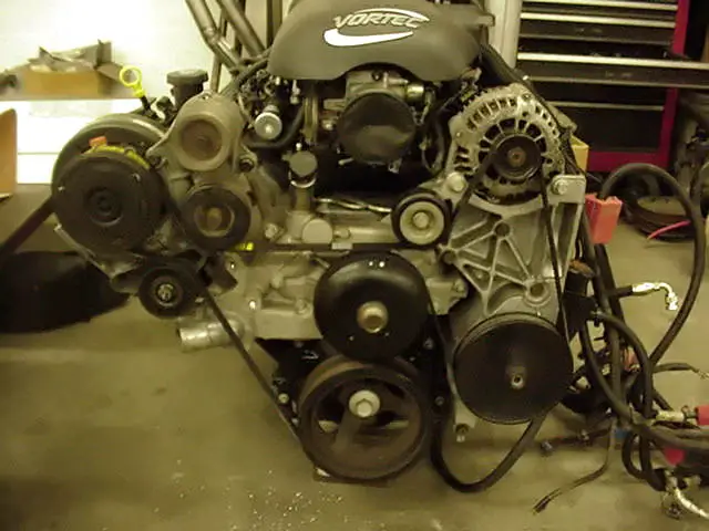

I am using an A/C bracket off an S-10 to use a R4 style compressor. It will be located at the top passenger side. It bolts right to the passenger head and aligns perfectly. Additional braces will need to be fabbed, because only one bolt goes in the head. It will use the existing Malibu A/C controls. Here is a picture of what it will look like when I get it completed (picture from LS1tech.com):

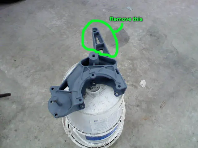

The bracket will need to have part of it removed. Here you can see the part that needs to be removed. Here it has been sandblasted and primed:

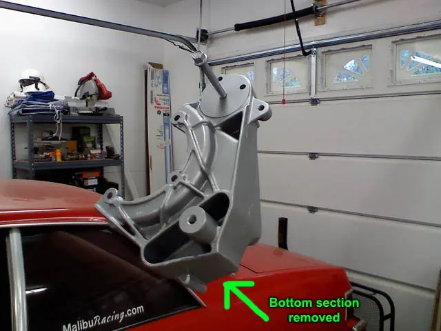

Here is what the bracket looks like after removing the bottom portion of the bracket with a cut-off wheel. It has been painted with aluminum paint:
