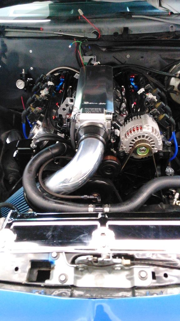

The same rad that was in the car with SBC.
[url][URL=http://s1275.photobucket.com/user/thunder938/media/IMG_20160731_113650_zpssbhzoeyo.jpg.html]Image[/url][/url]

My rad. is just a alum. V8 unit that was in the car before, I have a doulbe elc. fan set up and a ton of room between the rad and motor. I have 1 inch set back plates on the motor mounts, I am running a th400.
