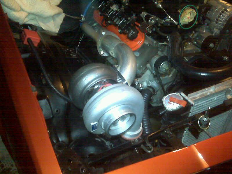

winter project step one....trial mount turbo, check
5.3 LSX...FI, Turbo.

just 6psi, no meth. I gave the nitrous kit to my brother...

Nice, what manifolds are you using? Looks like a vette one on the pass side?

edelbrock F body shorties.

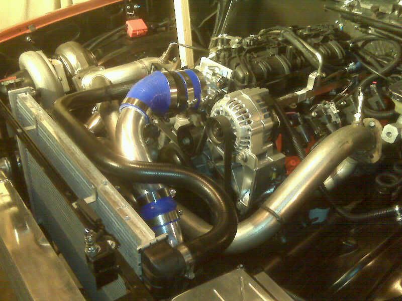

making progress....doesnt happen aften, but my old air filter and tube fit perfect

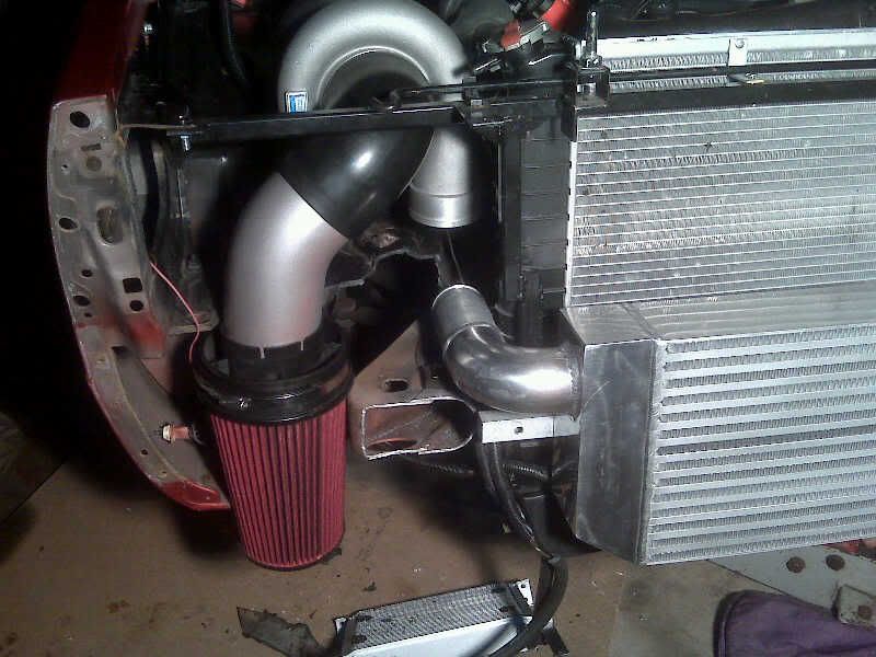

cold side done.

Nice build.. What size turbo are you running?

cheap ebay gt45 clone

Nice set up watch the O2s. You have them mounted pre turbo and this presuure can change the the way they read. You may want a post turbine stand alone or if your tune allows to move them post turbo.
Nice looking wagon.
