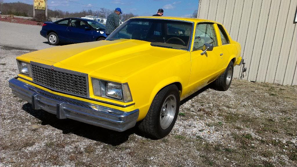

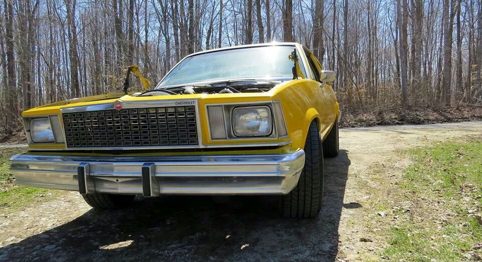

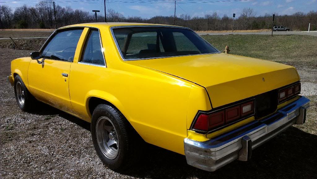

Start out with a pic or two of the car. 79,xxx original miles. The last couple pics are taken with a real (non cell phone) camera. The paint has a lot of pearl
I plan on painting the pillar semigloss black as I don't have the money or patience to cut it out and do the classic coupe swap.

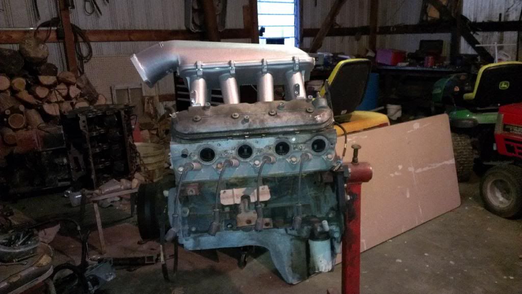

And a picture of the parts stack as of today
Ordering a cam kit tomorrow (230/235 .6XX), a walbro 255, and a vette filter reg combo. Eventually going to get a built motor with a snail, for now I just want to enjoy it while I save parts money. I think all I need is a converter/flexplate spacer, a couple fittings, and some fluids. I hope to be able to pull the stock locked up 305 some time next week and put the 5.3 in. Probably buy a cheap Assed jegs converter and use the stock trans for a while.

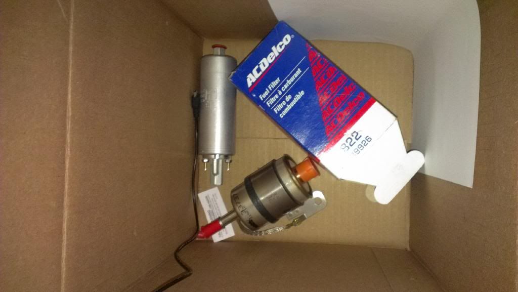

Not much but felt like Christmas lol. Walbro and filter/reg to get it up and running. Hope the weather is nice enough to work on it this weekend
 Post Posted: Wed Mar 26, 2014 4:22 pm
Joined: Sun Jul 13, 2008 10:02 pm
Posts: 381
Location: central Ky
I noticed the walbro didn't come with fittings... Anyone have ideas on the size? Also, the outlet on the regulator looks like a pushlock of some sort, got to a junkyard and find a fitting?

The walbro should be a 10mm x 1.0 thread pitch. And I assume you are talking about the fuel filter and not the regulator?
 Post Posted: Wed Mar 26, 2014 6:22 pm
Joined: Wed Oct 09, 2013 6:23 pm
Posts: 475
Location: Cedar Rapids, IA
Nevermind, its a filter/regulator. You can probably go to any auto parts store and get the plastic fitting, I also know that they do make push lock to AN fitting adapters.

Will do on the parts house. Probably take the pump with me and go through random fittings until I find something
 Post Posted: Thu Mar 27, 2014 3:24 pm
Posts: 475
its a 10 x 1.0 fitting for the pump. Auto parts store or even home depot should have a 10mm x 1.0 pitch barbed fitting.
The other fittings for the filter/regulator should be available at the auto parts store as well.
