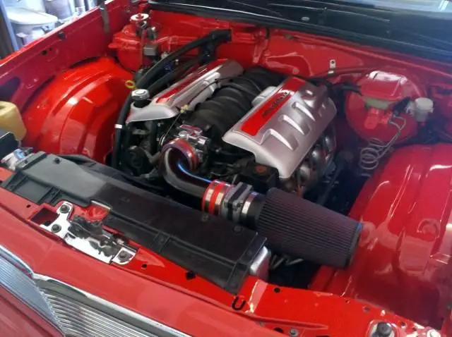

Older picture but I put mine on the driverside fender and repositioned the windshield washer jug. It works in this area for me, I just didn't want to take the time to reposition the harness and lengthen and shorten the harness to make it fit through the firewall into the car. Although next time the motor comes out I feel I will do what I can to fit it inside the car.
HTH

Clean set-up. Thanks for sharing. Does the car see a lot of weather?

It's hard to tell from this pic but the PCM is behind the passenger side head light under that black box that's in the corner of the pic. That is the fuse/relay box. It's a pretty clean set up but if I had done it, it would be inside the car in the kick panel like you mentioned.

Appreciate it! I wouldn't go out and say it see's a lot of weather as its a weekend/fun vehicle but I do take road trips in it and have put 8k miles on it in the last 7 months lol. Its the stock location as the Silverado it came out of, So weather isn't an issue.

Thanks. That explains the dirt on my pcm. I didn't realize the pcm was mounted outside of the vehicle. Alex, very clean set-up!
