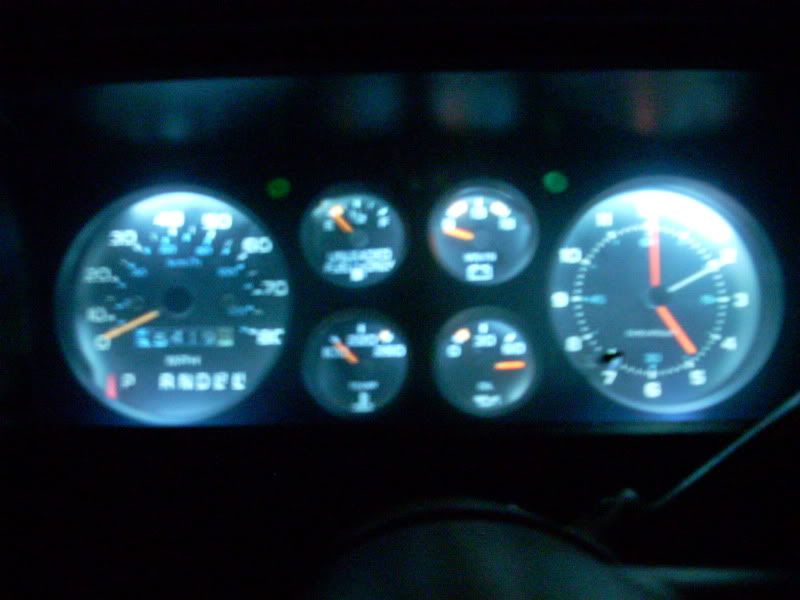

yes it is I just dont know why it is darker there, and yes they still dim a little bit but very little but the stock setup did the same thing I think that the switch is to blame on that one

I count 8 illumination bulbs... I'm guessing the one you're talking about is either a turn signal bulb, or one of the hold-down nuts for the cluster.

your correct doober with the lights on there are only 8 bulbs that burn

you misunderstand. In the assembled before/after pictures, the top of the speedo is dark, but in the unassembled pictures the bulb is lit. I am wondering if the top left bulb is working after being assembled.

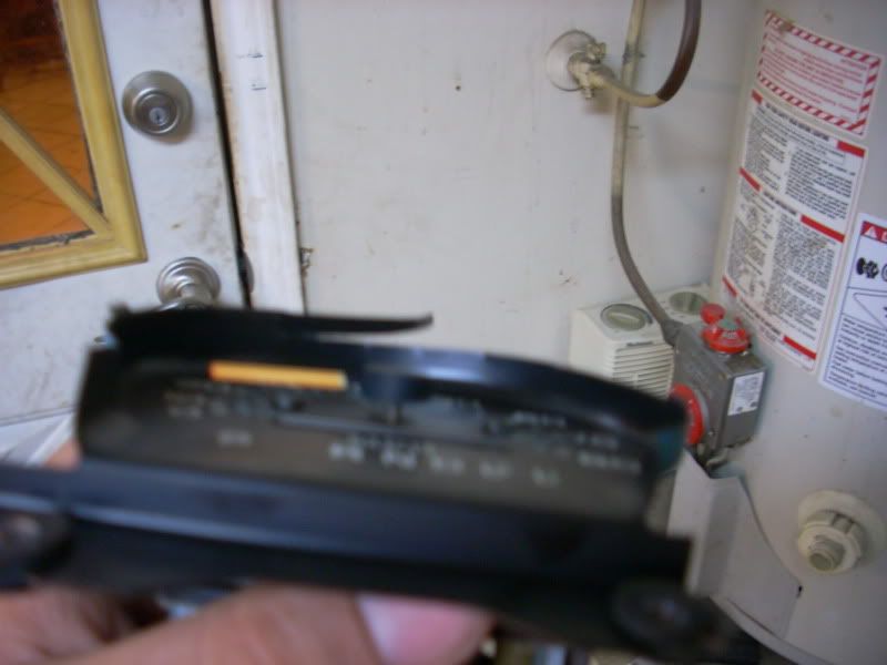

I understand what you meant and I think I know why it is darker there is a kinda eyebrow behind there because they are all burning when asssembled so I think I am gonna try and trim the "eyebrow" to see if it gets better here is what I am talking about

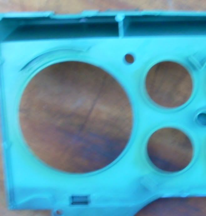

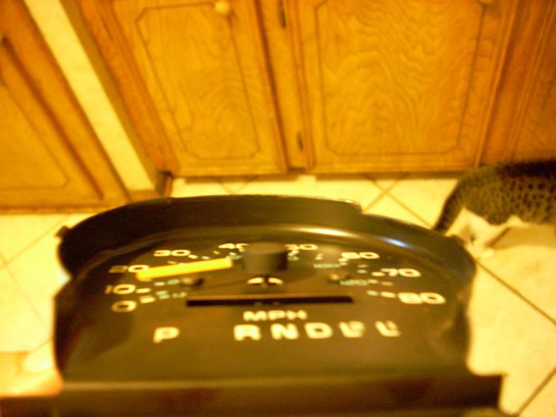

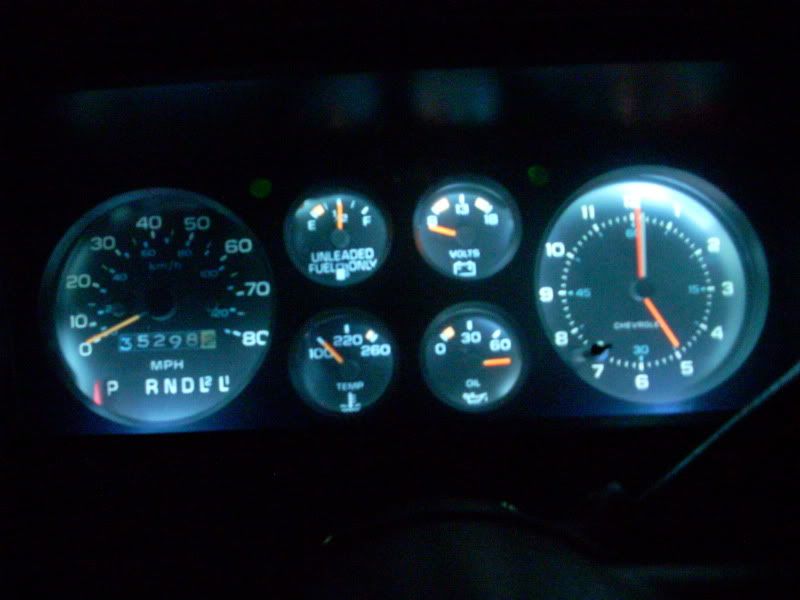

Alright guys got the lighting thing licked! Just for reference the "eyebrows" have no effect on the lighting as far as I can tell I trimmed them off and could not tell the difference, BUT what did make a big difference was trimming the speedo its self.
before
speedo before trimming
what I trimmed I removed this piece but left it in this pic for reference
Final product

Looks great, I did the same thing on my elcamino when I had it. Trimmed speedo, painted everything. Love it!!

thanks it made it 110% better at night

Wow! That made a huge difference. I still like the led bulbs though.
