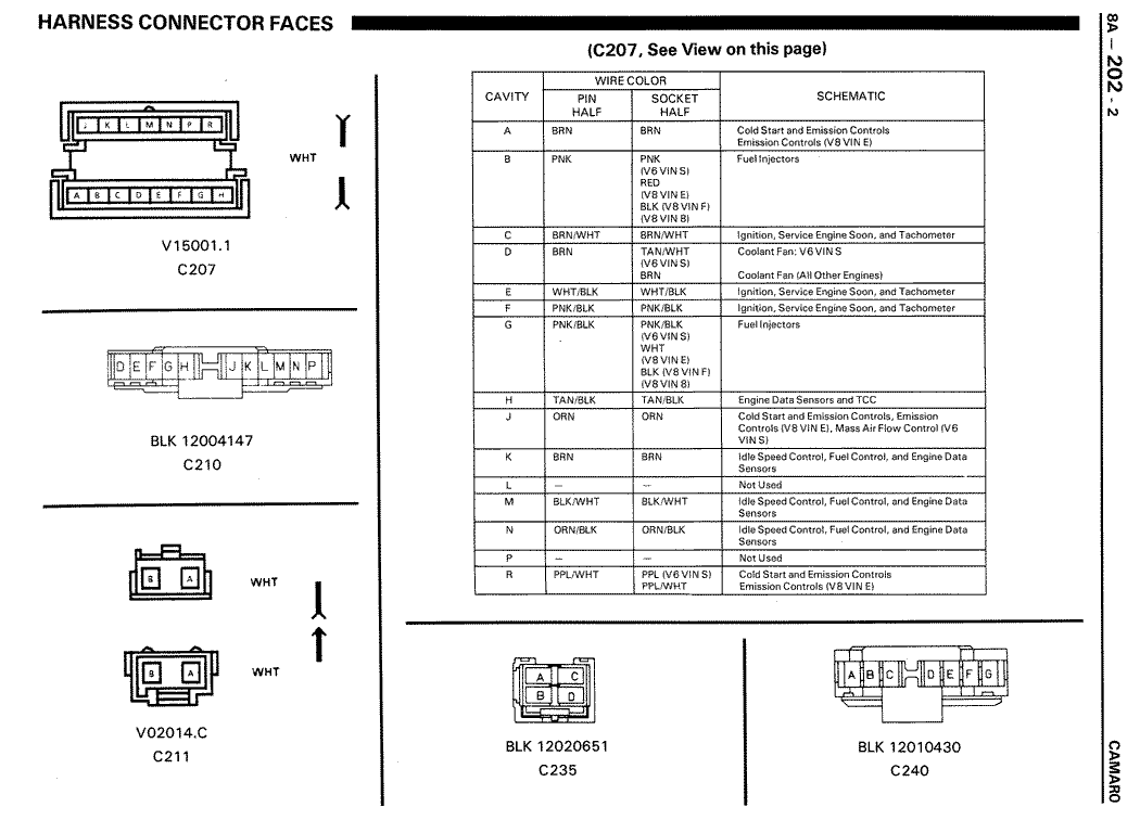

Hey, i'm swapping adding TBI injection to my 83 El Camino. I bought an uncut 4.3 tbi harness from a Monte Carlo. Under the dash where the ecm connects there's a white c207 connector, i found the pinout here:
I have A,B,C,E,F,H and D,G,R,J are missing, can someone tell me if they have those if they are using a factory tbi harness, if they are needed, or where to get the missing connections from? Thanks

Bam! This is why I'm always raving about Bob and the EBL... awesome service, even with unrelated questions to the customer. Sounds like you're using the diagram from a Camaro?
I went through the wiring for a '87 4.3l Monte Carlo. In that car this is connector C434.
D & G This is ignition switched power. Make sure that it is ignition, not accessory power. Uses a 7.5A fuse and powers the injectors.
J ORG I couldn't find this terminal. Orange is usually battery power.
R This is from the 3A cranking fuse in the fuse block. It is hot whenever the starter is activated. Lets the ECM know this.
I wouldn't go by that Camaro diagram of C207 either. As terminal B for the '87 Monte is power back to the fuel pump and as an input to the ECM.
N is shown for the P/N switch input to the ECM.

dancin_banana.gif Man thanks so much!!! I was wondering why i only had power to one injector. But now i don't know where the power for the fuel pump comes from. Could you ask for all of the pins? With a promise to get a EBL in like 4 months?
Edit: Yes, I went home and wired up pin D and that gave me power to my other injector. I just need to figure out how the stock fuel pump is wired. Trying to avoid tapping into the wire coming from the fuel pump relay. I still have to finish putting in my pump. upgrading fuel lines, and intake....but i might be running this weekend... \:D/
