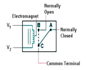

OK, help me understand this. When I switch to turn signals what happens to the other brake light it goes out right? I thought about using a normaly closed relay, but when I turn the signal on it's a off/on/off/on signal and the relay will see this and open close which will not keep the brake light on. Still need help!!
You would need a separate SPDT relay for each side. I don't have a way to easily make/draw a schematic right now so I'll just use one for the relay.
V1 and V2 will be the trigger from your switch. Terminal B would come off the flasher (which has ignition-switched or constant 12v on the other flasher terminal), terminal A would come from the brake light switch, and terminal C would go to each of your brake lights. Depending on which side you select with the switch, the appropriate relay is triggered, opening the circuit from the taillight switch and closing the circuit to the flasher. The OE turn signal switch has this functionality built in... it's basically a 4-pole, double throw switch, with two poles for each of the taillights.
