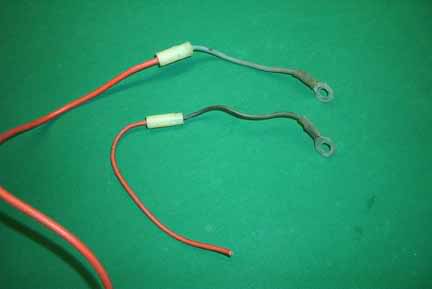

The OE fusible link looks like this, a small plastic/rubber cylinder around the wire:
Sometimes if it's been replaced and burns up it looks like this:
If you don't have a fusible link or fuse in-line here, you risk a fire if it grounds on something.

Don't just keep it in mind, install a new fusible link. NOW. It saved you last time from possibly melting wires and you might not be there if there's ever a next time. That piece protects all the wiring (except the battery cable) in your car that has power all the time (even with key off).
I think for mine I'm going to do a fuse block for each of the wires... beats splicing in another fusible link imo.
You can't replace a fusible link with a fuse block. Fuses are not designed to operate under the same short term high loads a fusible link can handle without blowing. If you get fuses big enough to handle the load, you're inviting a fire...
