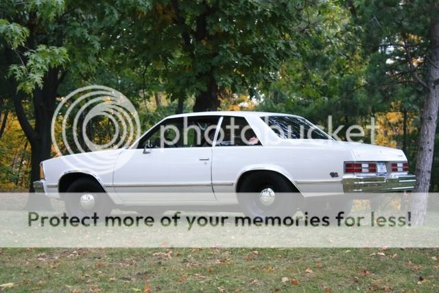

I dont have any pics with the Draglites on, just put them on Wed. night :lol:,,,but,,,, here is a couple of older shots with the GM 8"Wide by 4" BS steelies same tires as on the Welds,,,,,Still have the Monte SS springs,,,8 yrs running those springs,,,,,,,,,,,,Like anything with age, they are probably "sagging" a bit :lol: :lol: Last year I changed to 3" X-pipe exhaust and have since tucked the exhaust up more and plan on dropping the rear 1" more this season................

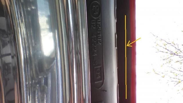

The pic here is from the center of the wheel looking up. The yellow line represents where the fender lip is after rolling it and spraying it with black undercoating to stop the paint from chipping.

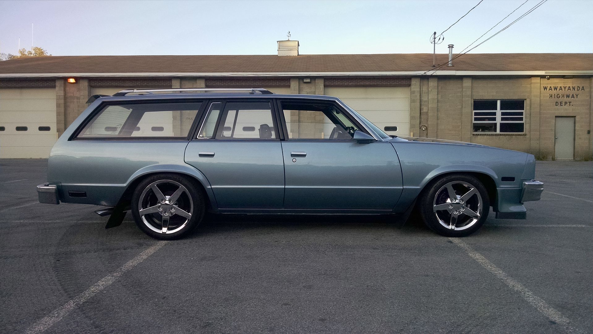

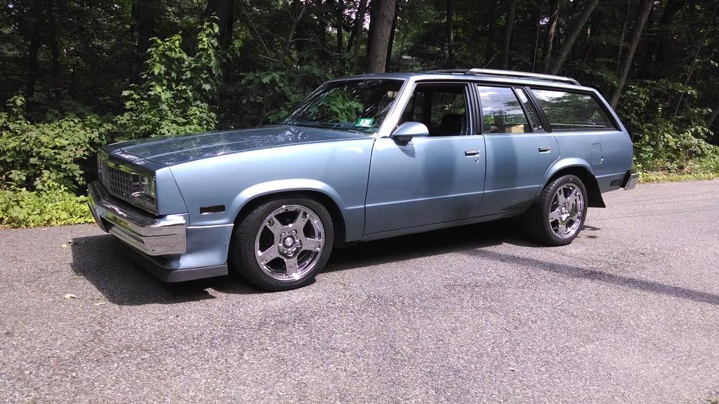

1999 (?) C5 Corvette "wagon" wheels (what else to put on a Malibu wagon :lol: )
Front - 17 x 8.5 with 245/45/17 Michelin Pilot Super Sport tires and a 2" spacer.
Rear - 18 x 9.5 with 285/35/18 Michelin Pilot Super Sport tires and a 3" spacer.

updated pic with the new wheels.
