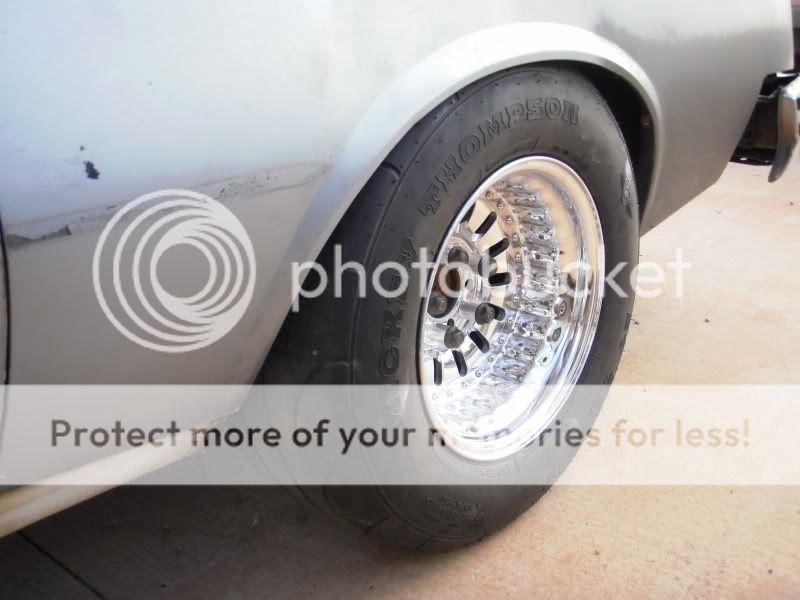

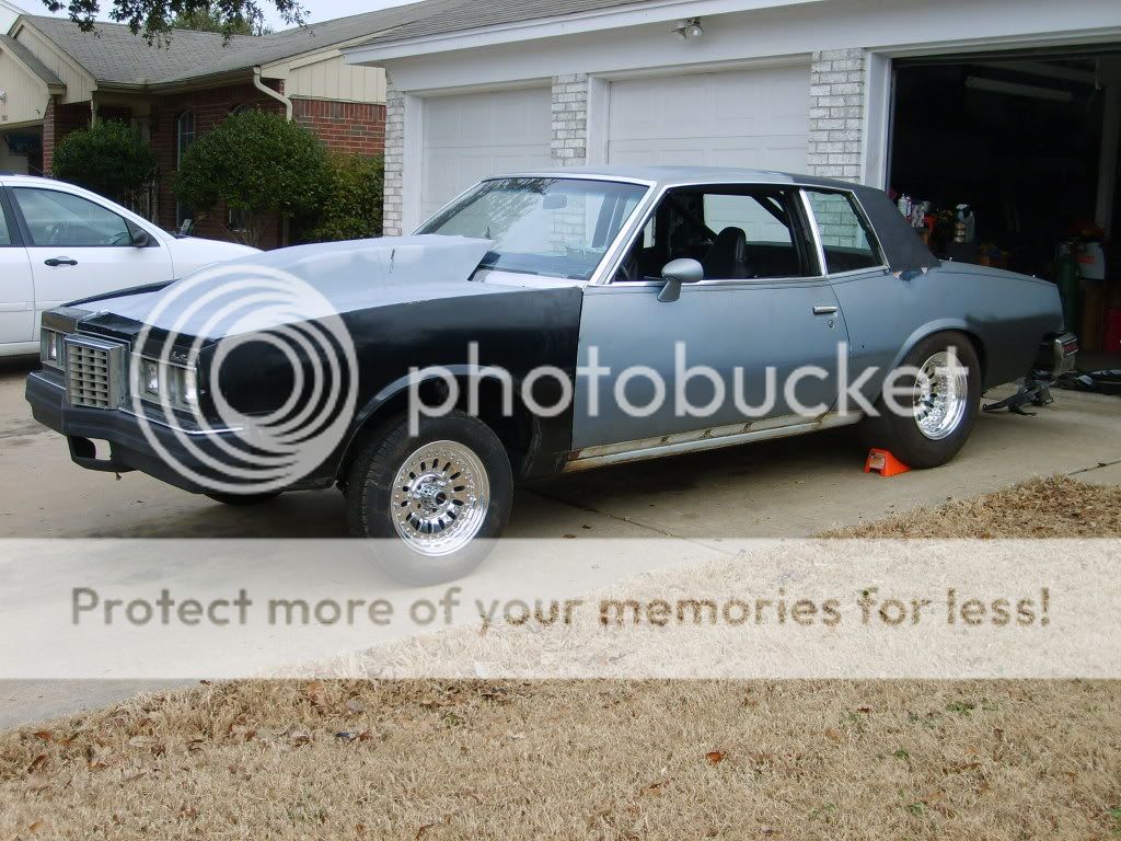

Haven't posted my wheel tire combo in a while, and never in this thread so here goes...
Front wheels are 15 X 4 and have 1.75" backspacing. Have 205/75/15 (27" tall) tires mounted on them.
Rear wheels are 15 X 10 and have 7.5" backspacing. Rear tire is M/T ET Street 28 X 12.50-15.
Have a '68-'72 Chevelle 12-bolt rear, 12" 150 lb coil over springs, and full/max frame notch with 36" mini tubs.
On the way to the shop for cage, tubs, and chassis work.
By malibulvr at 2011-07-08
Just came back from the shop I think my cage is hidden pretty well from the side view. Please excuse the driveway mattresses as I also was convinced by the wife to replace our mattresses the same day I brought my car home.

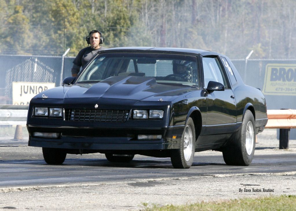

 Post Posted: Sat Oct 29, 2011 1:51 pm
Joined: Sun Dec 13, 2009 1:02 pm
Posts: 433
Location: Matawan,NJ
Just your typical 11 second 305ci smallblock.... Yeah Right!! LOL
