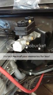

Here is a list of strait bore master cylinders that will bolt up to a G-body’s angled firewall when using a flat, manual brake adapter plate. This is a list from smallest to largest.
21mm (0.826”) bore 1993 Dodge Shadow master cylinder (other years and models may work)
• Requires adapters to mate master cylinder outlet to stock lines. The adapter Part number is MC-SF at http://www.classicperform.com.
• Mounting holes spaced 3.25” versus GM master cylinder’s 3.375”.
• Hard to find.
• Light in weight.
• Advertised as 21mm, but may be delivered in 7/8” or 24mm bores. Measure bore size before you buy. Rebuilt/Used ones will have a “1” cast into the front of the aluminium body under the reservoir.
• Can buy new or used. New ones are fairly cheap to purchase.
• Aluminium body – new, used, or rebuilt.
• Large reservoir can hold enough fluid for rear disc brakes.
7/8” (0.875”) bore 1978-1980 GM G-body manual brake master cylinders.
• Can buy new or used. Rebuilt are fairly cheap. New are fairly expensive.
• Reservoir too small for rear disc brakes. The reservoir from 1979 Buick Riviera with four wheel disc brakes can be retrofitted to this master cylinder.
• Advertised as manual brake units, but may be delivered as a 24mm, vacuum power boosted unit. Measure bore size before you buy.
• Bolt in.
• Cast iron body – new, used, or rebuilt. (no aluminium)
7/8” (0.875”) bore 1993 Dodge Shadow master cylinder (other years and models may work)
• Easier to find.
• Light in weight.
• Advertised as 7/8”, but may be delivered in a 24mm bore. Measure bore size before you buy.
• Rebuilt/Used ones will have an “8” cast into the front of the aluminium body under the reservoir.
24mm (0.944”) bore 1978-1980 GM G-body power brake master cylinders.
• Can buy new or used. Used are fairly cheap. New are fairly expensive.
• Bolt in.
• Come in cast iron and aluminium. 1978-1979 are cast iron. 1980 is aluminium (some models i.e. El Camino).
• New master cylinders will most likely be cast iron regardless of year.
• Rebuilt units come in cast iron and aluminium (1980 – some models).
24mm (0.944”) bore 1993 Dodge Shadow master cylinder (other years and models may work)
• Easiest to find.
• Light in weight.
• Advertised as 24mm, but may be delivered in a 7/8” bore. Measure bore size before you buy.
• Rebuilt/Used ones will have a “4” cast into the front of the aluminium body under the reservoir.
24mm (0.944”) bore 1993 Dodge Dakota master cylinder (other years and models may work)
• Rear brake line outlet is 9/16-20 versus GM rear brake line fitting of 9/16-18. The fitting for GM brake line may be used to “rethread” the master cylinder’s outlet.
• Front brake lines bolt up.
• Reservoir not angled like above Dodge and GM master cylinders.
1.0” bore 1979 Buick Riviera with 4 Wheel Disc Brakes.
• Reservoir is made for rear disc brakes.
• Bolt in.
• New master cylinders will most likely be cast iron.
• Rebuilt units usually come in aluminium.
1 1/32” (1.03”) bore 1985 Dodge Diplomat master cylinder (other years and models may work)
• Rear brake line outlet is 9/16-20 versus GM rear brake line fitting of 9/16-18. Fitting for GM brake line may be used to “rethread” the master cylinder’s outlet.
1 1/8” (1.125”) bore 1985 Dodge Ram master cylinder (other years and models may work)

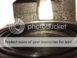

LOW DRAG SEALS
Though the description says "low drag seals", the seals are square with no noticable taper.
The seal-groove in the bore of the caliper are also square with no noticable taper.
When the seal is installed, it barely clears the top of the bore, and because of this, the piston to bore clearance, it seams, to have fairly tight tolerances.

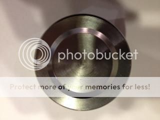

The small end of the piston is what contacts the back of the brake pad. It measures 2.38".
The large end of the piston is what is inside the bore of the caliper. It measures 2.50"
Inside of piston cup, facing the brake pad.
Backside of piston that is installed inside the caliper bore.

A Kit install with adapter plate painted satin black to match firewall better.
