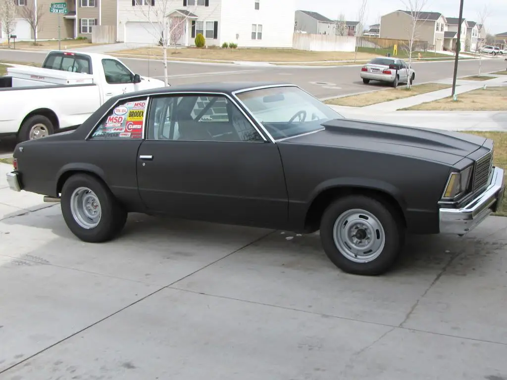

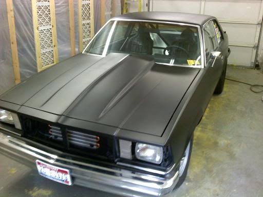

I used the Blitz Black with the recommended JD primer. Wopping cost of $100.00. I think it's been on there for about 4 years now. No problems at all, but also always garaged.

Mine has never seen rain aside from the occasional drizzle at the track or something. I used the JD hardener and thinner as recommended. Instead of mixing 8 to 1 we mixed 9 to 1. The JD primer is yellow and took a day to get hard enough to sand without it clumping on the sandpaper. No problems with scratching. I've never done anything to the paint other than wash it.
